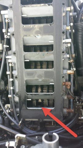

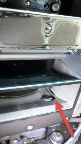

Reeds usually are either working or broken/gone, if you get a strong flashlight and open your carb throttle plates all the way open you can usually see the reed block, attached are the pics from my Yamaha 250 HPDI that had a broken reed valve, and the piece was laying in the crank case plenum area stuck in the 2 stroke oil, I saw this "black hole" looking through the throttle bodies (no carbs on this motor it was fuel injected). This is probably not your problem, but its a good learning experience for future use.
- reed valve piece.jpg (23.87 KiB) Viewed 3018 times
- broken reed.jpg (27.8 KiB) Viewed 3018 times
