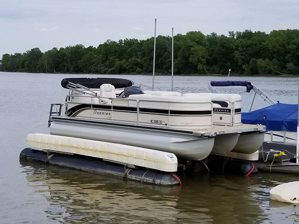

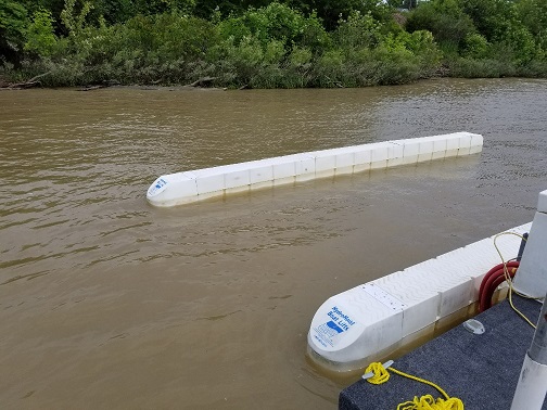

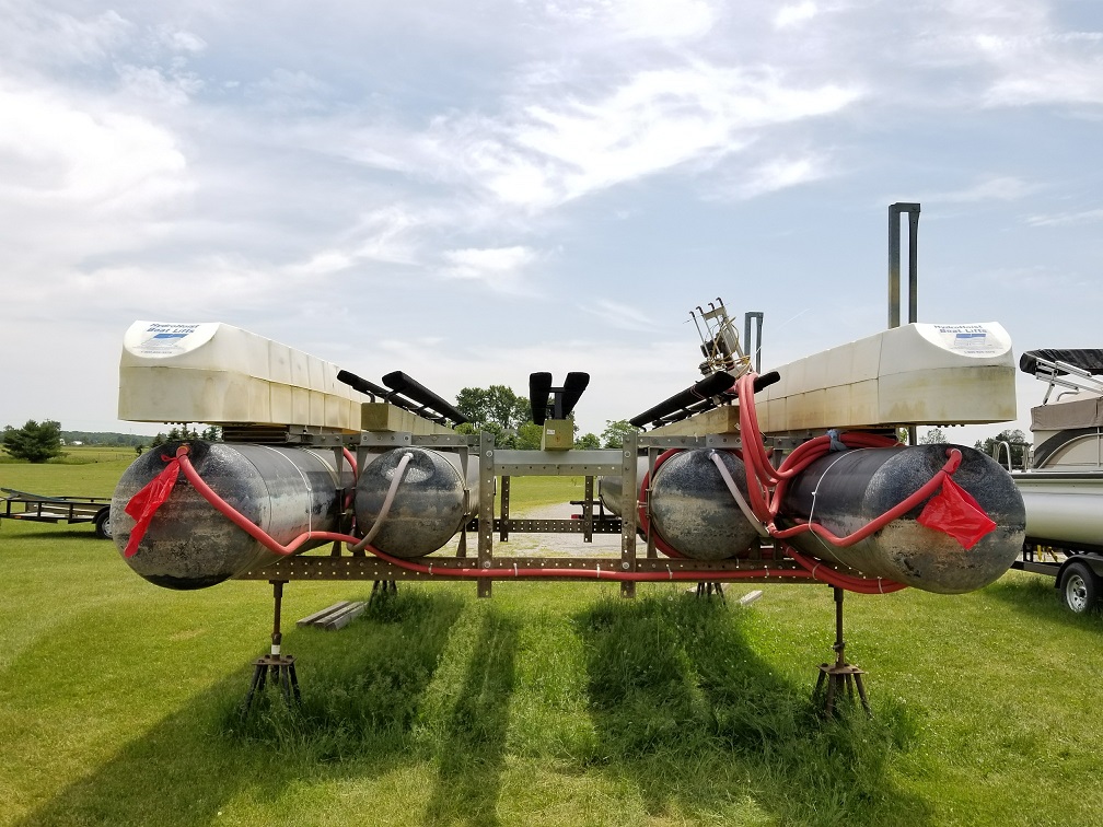

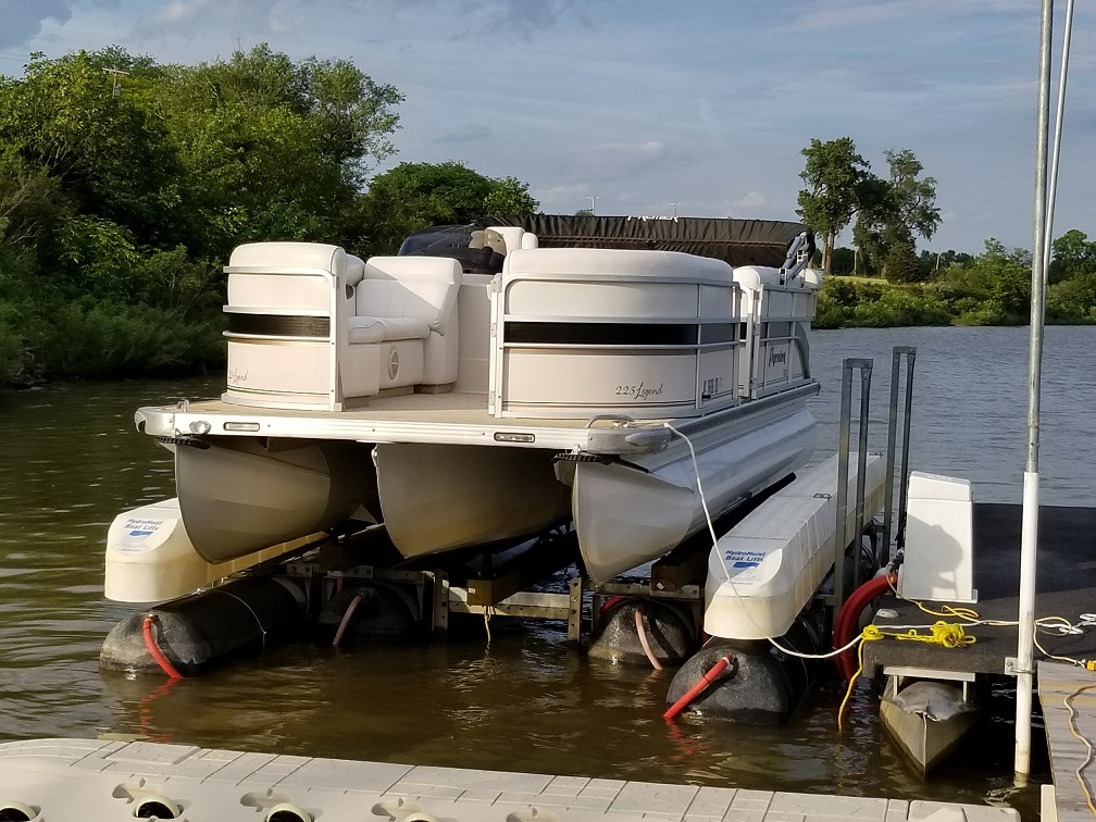

Here is my Hydrohoist lift:

I really like that set up too. Unfortunately, our river bottom was too shallow at points near the dock to accomodate something like that. Looks like it works a treat though.

I didn't realize the cubes had air chambers that you could let air out or blow it back up. That would make it more convenient. I have a very old HydroHoist boat lift (Model A) that they don't sell anymore. It scares everyone when I lower or lift the boat because the only inlet on the bottom-side of the tanks is at the back end. So it doesn't raise or lower the boat level - the stern is usually a lot lower which scares everyone when they watch it. Once the 2 tanks are completely filled, it sits closer to being level.
