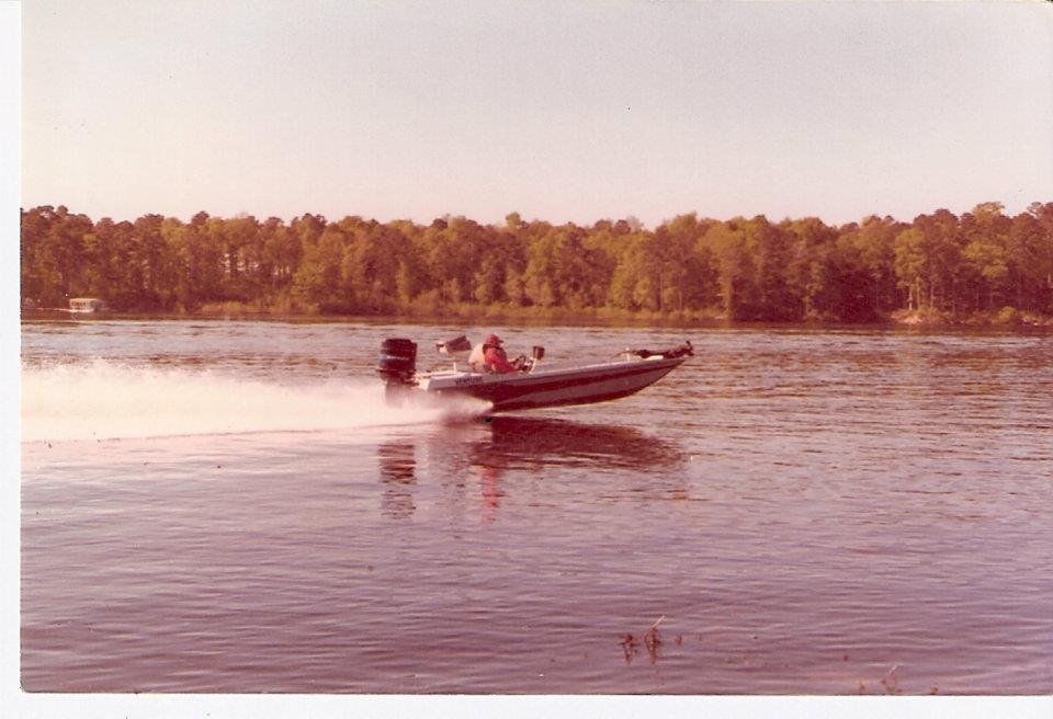

not sure about the slip calculator---hope others chime in. I plugged in numbers for my old bass boat--- 1979 Venture with 115 hp 6 cyl and a 13 x 19 cupped SS prop It was a 55 mph boat. Slip calculator computed a minus 9% ! What does that mean--I know it was fast but negative slip? Enclosing pic of the boat.
