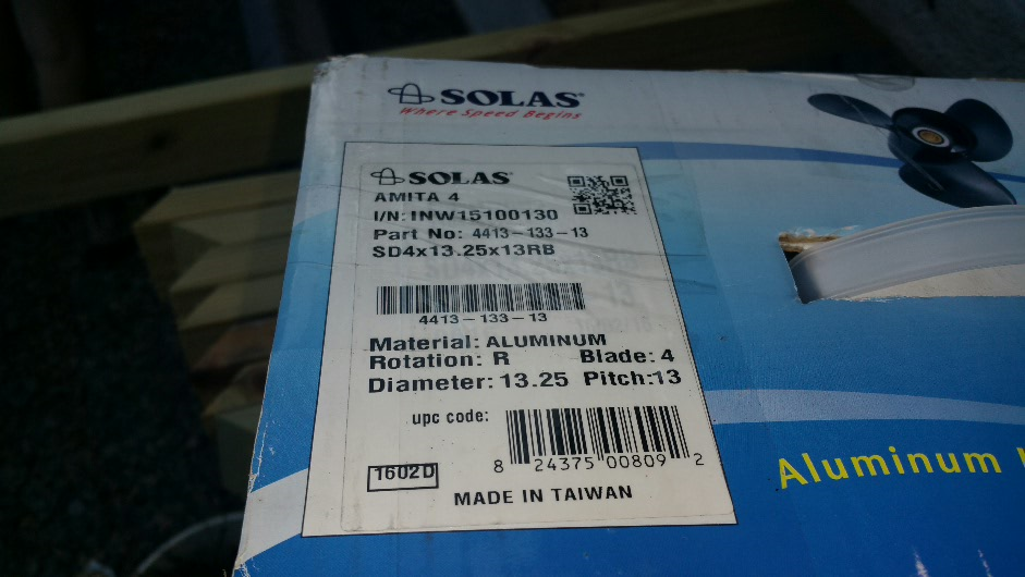

Well after talking with propgods and a couple others, i found a NOS--> SOLAS AMITA 4 SD4X13.25X13R 4413-133-13, comes with a suzuki hub for wayyyyy cheaper, box is really faded, prop looks NIB though
It should give me a couple mph but biggest advantage should be more low/mid torque to fight current and wind and should be moar efficient mpg, we will see hopefully next weekend

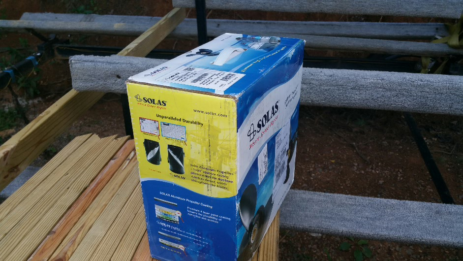

#23 Post by bansil » Wed Aug 08, 2018 10:03 am
So the man in the brown truck drop this off yesterday
Hopefully can get it changed this weekend, will I need a puller? of just a rubber mallet?

#24 Post by wwind3 » Wed Aug 08, 2018 1:40 pm
Do you have a cotter pin holding prop? Usually just remove pin and unscrew the locking nut. I use a block of wood to wedge the prop against the motor to keep it from spinning--no hammers needed probably.
Big Crescent wrench should do the trick
