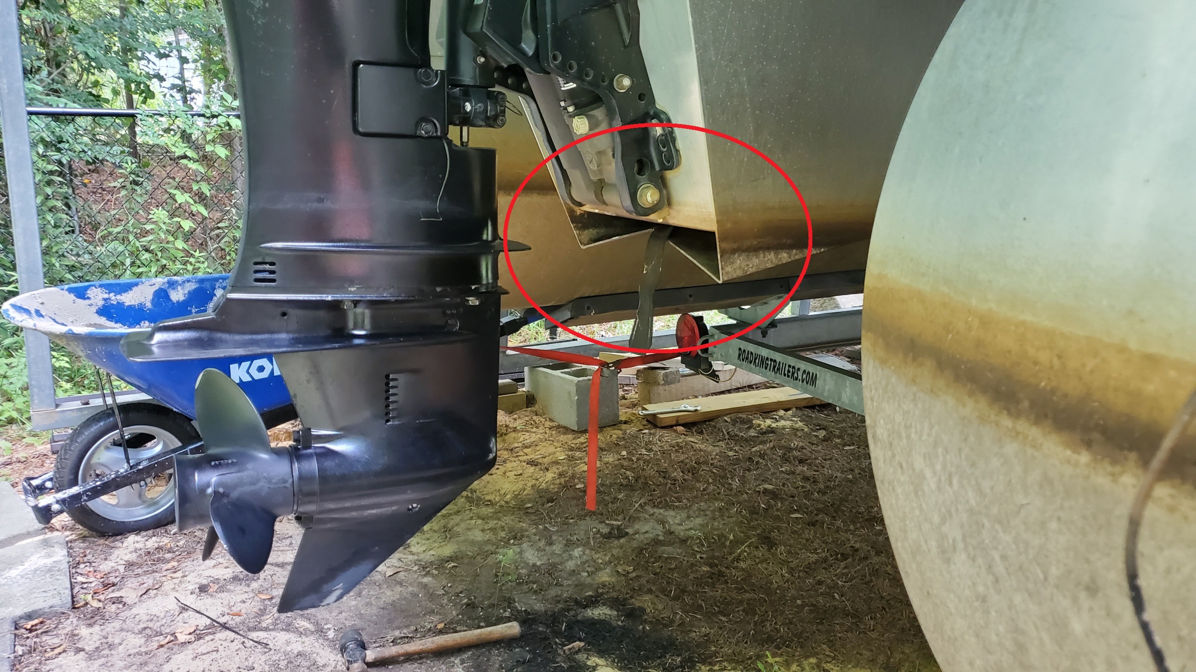

I asked this before and got no response so we'll try again....what's going on with this? Is this bent for a reason?
60HP Mercury 2 stroke

Re: the bent motor pod.. Looks like it's built that way unless you can see any damage---i would think hitting something might crack it. Maybe it's to channel the water around the cavitation plate--create a smooth flow like air over a wing. Mine doesnt bend.

As far as the transom. I believe the V shape or bent look is from the factory as I do not see any cracks or repair work. I have only had this pontoon for 2 months.
