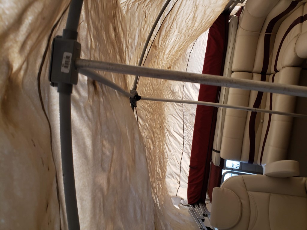

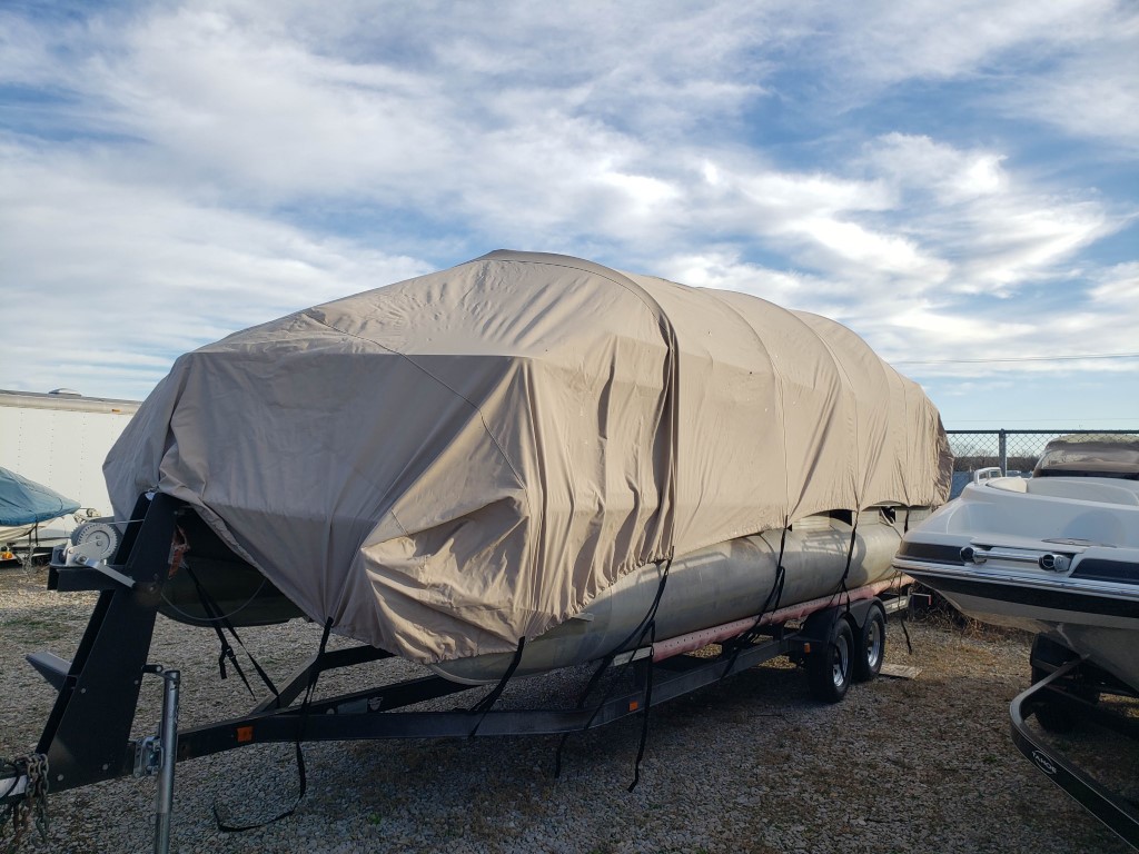

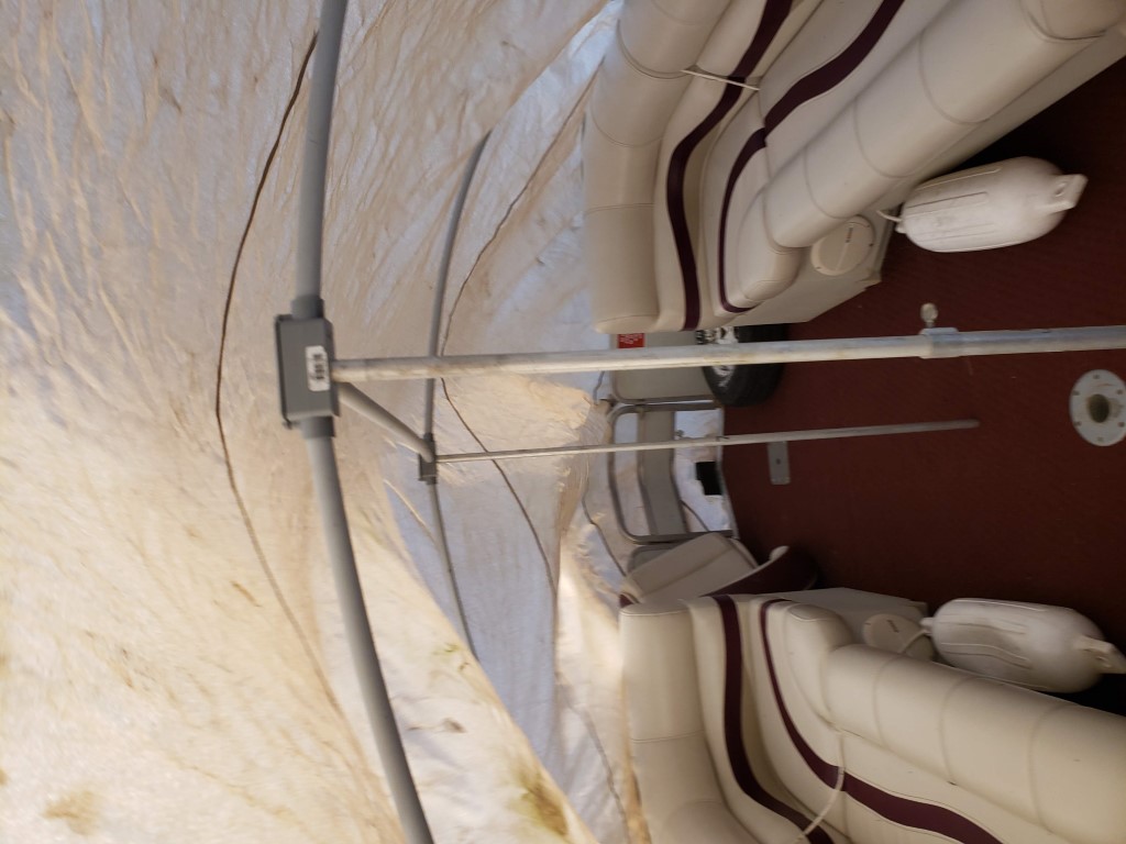

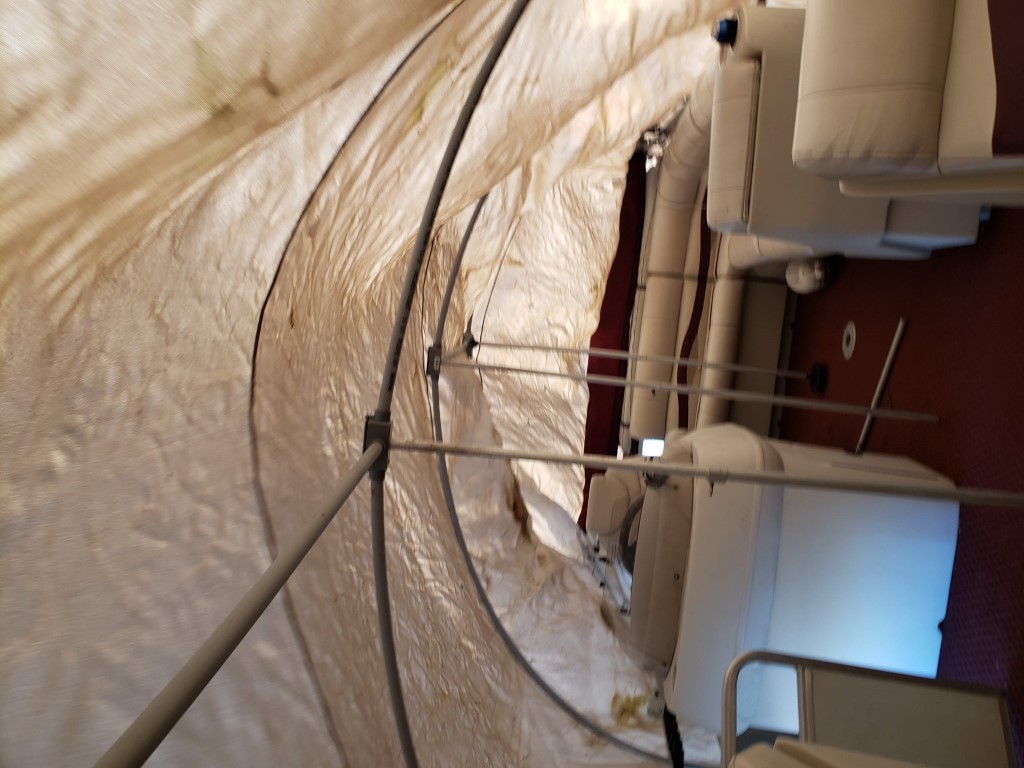

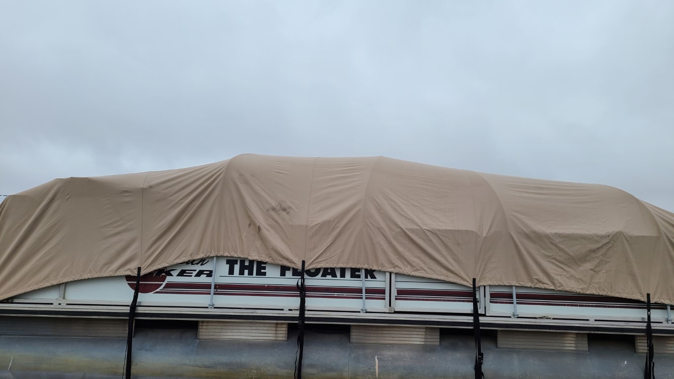

Well damn if it doesn't look like a covered Wagon TWB!

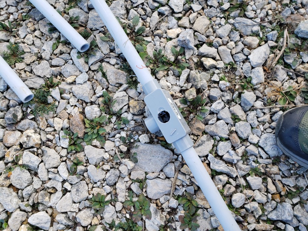

I decided to put vertical poles as well to keep it from sagging. I drilled a hole in the T-box to keep poles from slipping.
The inside pics are before I got it all tightened up. We'll see how she does!

Nice job, Craig!
Just put the horses in the barn and you should be good through the off-season!
Just make sure Cookie turns off the chuckwagon stove or you could have a fire. That would attract injuns!

Looks good Craig... nice job. Only place I'd be a little concerned about is at the front end, just inside the front gate.. From the pics looks like a low spot where water / snow could pool.. but maybe it's just the vantage point of the picture.

Thanks everyone! I did tighten that spot up some. It's close enough now I can check on it in 30 minutes.... We'll see.

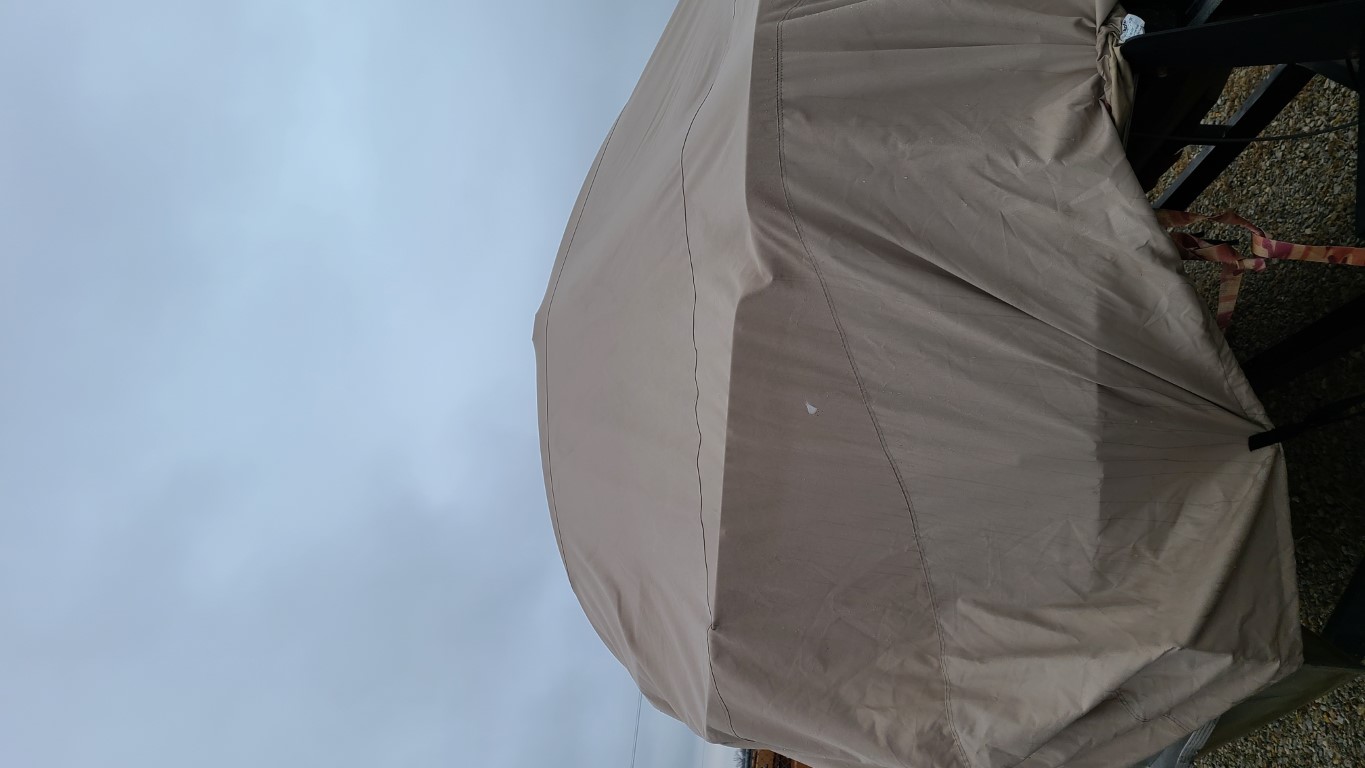

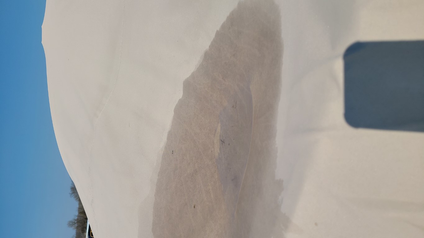

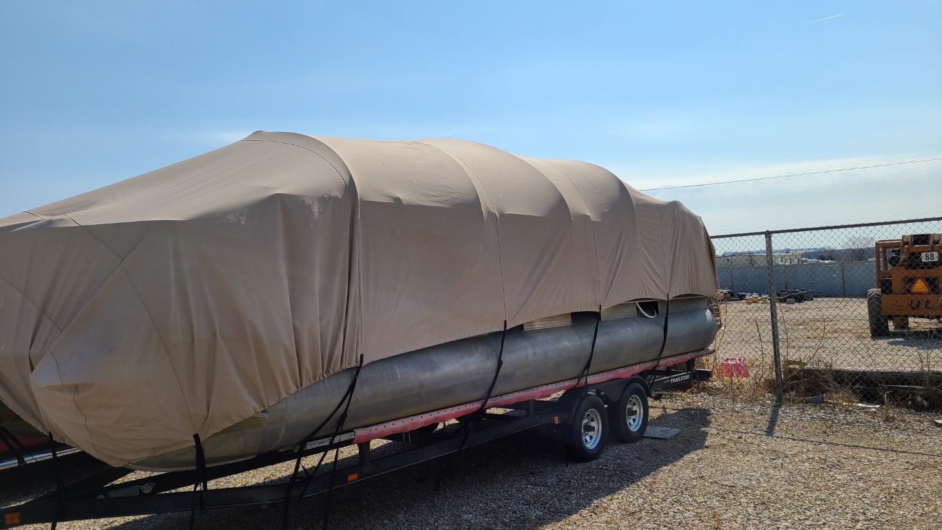

went to check on THE FLOATER after 40 -50 mph gusts and 1-2" of rain. Bow was perfect had some pooling in stern so pushed that out and tightened it all up back there. I may need to add another support there. All in all I think I nailed it!

You can buy those vents like come on fitted boat covers for about $10 and the telescoping support poles aren't much more. Could put one in front and rear. I think they probably work better than those mushroom head standalone poles because the vent installs/clamps into the cover and then the pole inserts into the vent.

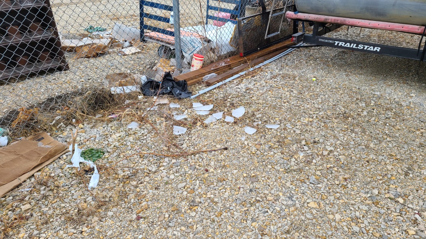

#26 Post by curtiscapk » Mon Jan 25, 2021 1:51 pm

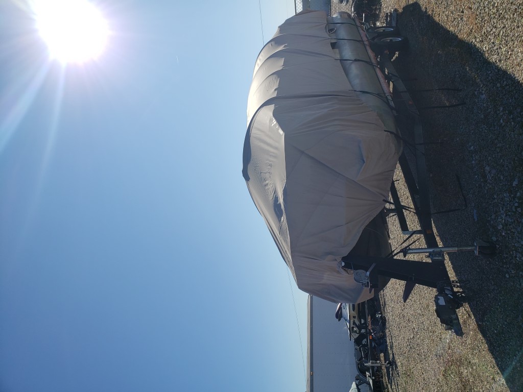

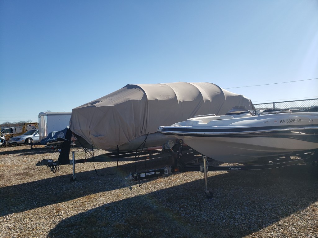

took another visit to check on cover. We had 3-4" of snow over New Years when we were at the beach then some rain. THE FLOATER had 2! gallons of water pooled and an inch of ice. After all these years of thinking about how to build it and then to have the support work makes me smile.

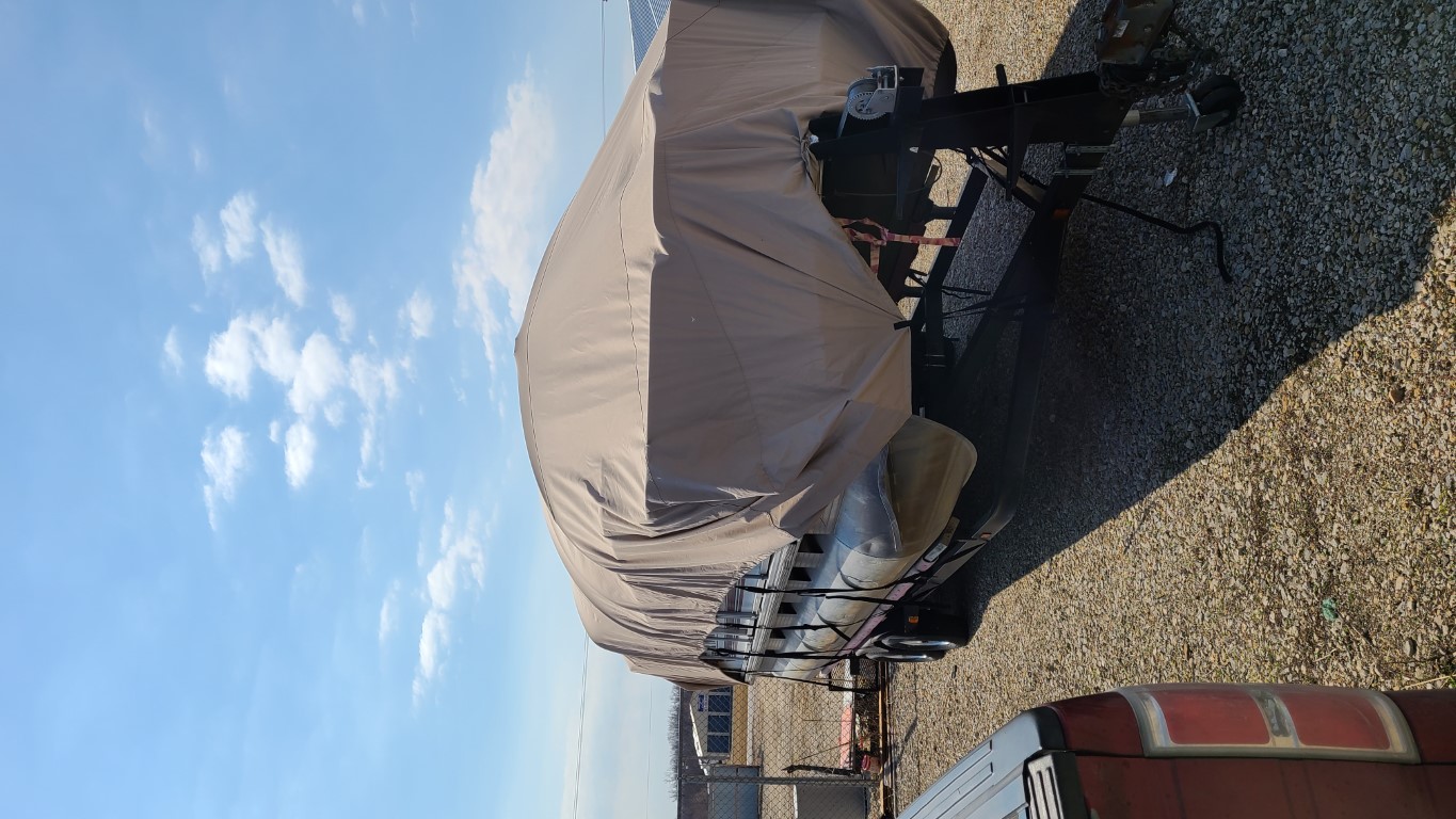

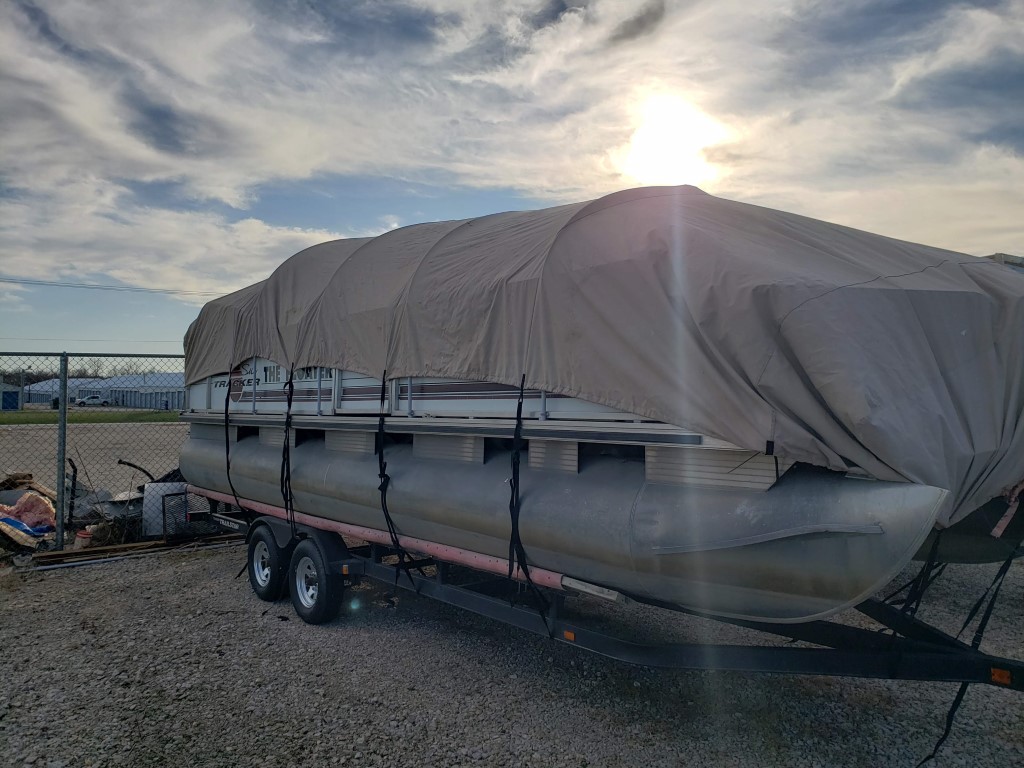

Thanks 2nd trip to check 3 weeks ago same thing totally supported. Finally found a winner!
