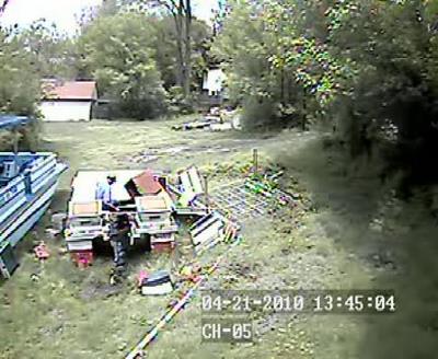

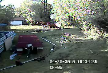

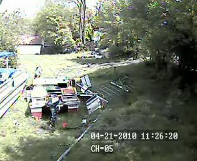

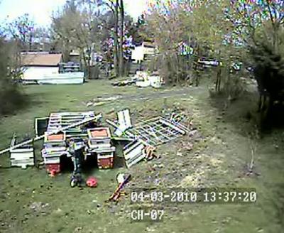

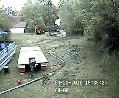

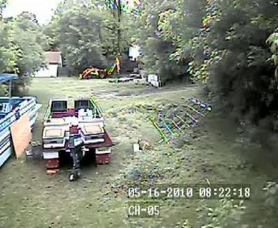

Re: pontoon sides
only cause you asked nicely.
- 20100430-183429-01-U.jpg (24.32 KiB) Viewed 3595 times
- Snapshot12.jpg (33.63 KiB) Viewed 3593 times
- Snapshot11.jpg (30.52 KiB) Viewed 3595 times
- Snapshot5.jpg (30.94 KiB) Viewed 3595 times
- Snapshot3.jpg (33.01 KiB) Viewed 3593 times
- Snapshot1.jpg (34.64 KiB) Viewed 3592 times
