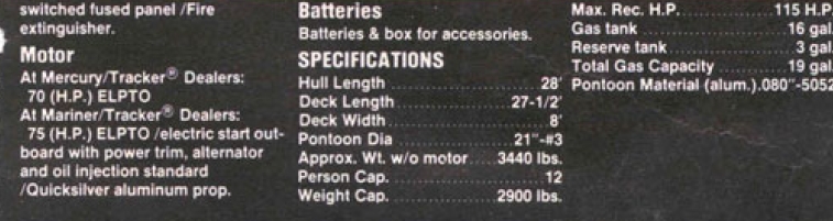

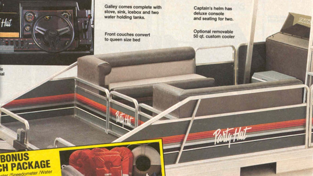

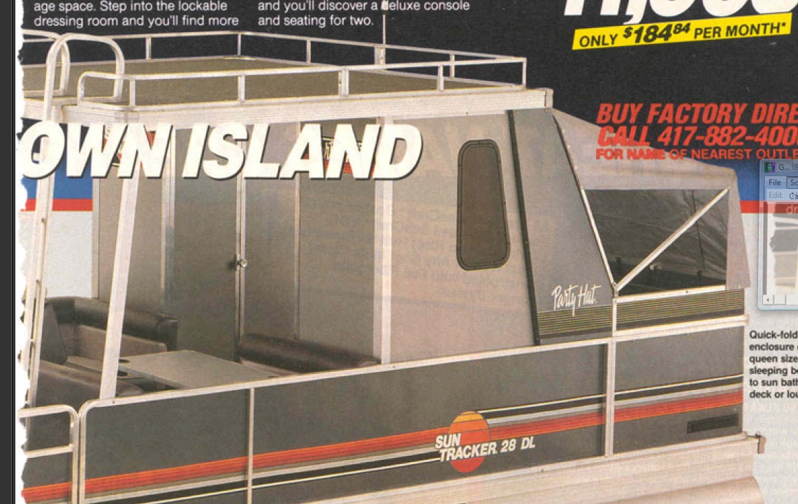

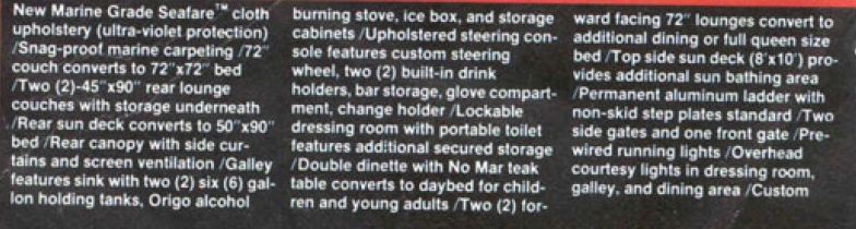

OK guys - here's where it gets interesting.
I actually found the original brochure with weight capacities, etc.
It shows a weight capacity of 2900 lbs. (or 12 passengers) and I'm already at 3200 lbs. with 4 people, the trailer and all gear.
Would anyone venture a WILD guess how much all the "stuff" above the deck weighs that I'm going to toss?
If it comes in at a thousand pounds I'm in GREAT shape... There's a lot of metal and wood up there and it would seem I could save an awful lot of weight by going to a honeycomb ($$$$) vs. wood decking which I'm going to have to replace anyway:

#22 Post by Rooster368 » Thu Sep 09, 2010 5:36 pm
I did not see any mention of 3 tubes in the brouchure...do you if the unit came from the factory with 3 logs, or was the 3rd one added aftermarket?
If your not sure you might want to call a sun tracker dealer to verify; that way you will know if the rated capacity is correct for 2 or 3 tubes.

Re: A folding travel trailer on top of a 28' pontoon boat.
#23 Post by RonKMiller » Thu Sep 09, 2010 8:12 pm
It does note "21", - #3."
Apparently what it does not say is that the third toon is only a partial unit, probably extending half the distance or less forward... but factory equipped according to the present owner who has owned it since day one.
Sun Tracker dealers - and I have talked to a couple - are less than interested in talking to me about a relic like this - that's why I'm here hoping some other knowledgeable owners of this unit or similar can chime in.
I don't understand their logic at all - not ONE of them has recommended buying a new one instead. (which I can easily afford)
All they want to do is get me off the phone. I guess that's what qualifies for sales and marketing these days in the industry. Either that or they are so depressed - and who can blame them - they figure they don't have a chance of selling anything in the off season (for most of the country.) Sad, really sad. :donno
#24 Post by BobL » Fri Sep 10, 2010 8:16 am
My bet is that your camper will be less weight than what is being removed BUT that is irrelevant at this point. In order to get this "certified", no one will care what was on it, they will care what the toons will handle.
You know:
The weight of the camper
The weight of the motor
The weight of the helm
The weight of fuel
The weight of the deck (or close to a good guesstimate)
You then have to show that 3 toons will handle the above.
