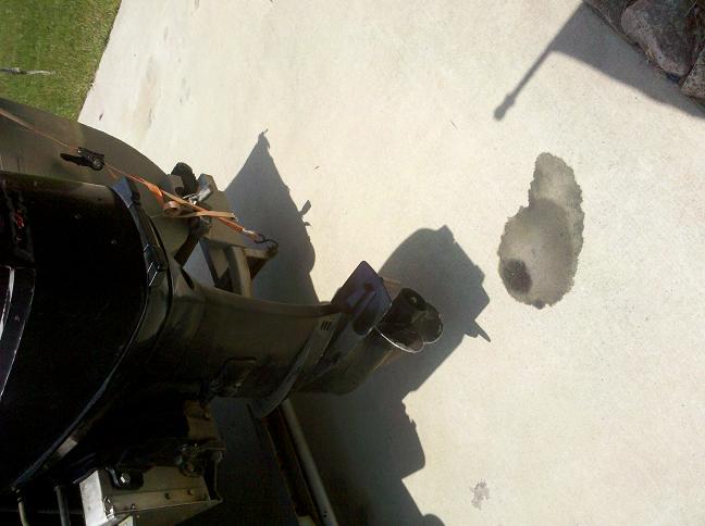

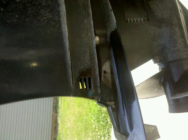

Now that my son is taking a nap I went outside to take a look at how the carbs come out and found this....
oil spot.jpg (58.03 KiB) Viewed 2706 times
It is leaking from that small hole

#29 Post by mossjer » Thu May 26, 2011 12:56 pm
That looks like fuel to me. If your motor is flooding it will come out of the exhaust. I'm not an outboard expert, but I am a ASE/Chrysler Mastertech.

#30 Post by curtiscapk » Thu May 26, 2011 1:32 pm
Flooded or leaking. it is either carbs fuel pump or accellerator pump. I cleaned my carbs and rebuilt my fuel pump. ( 4 bolts and gaskets it is easy) and bought a used acc. pump on ebay. No more leaks.
