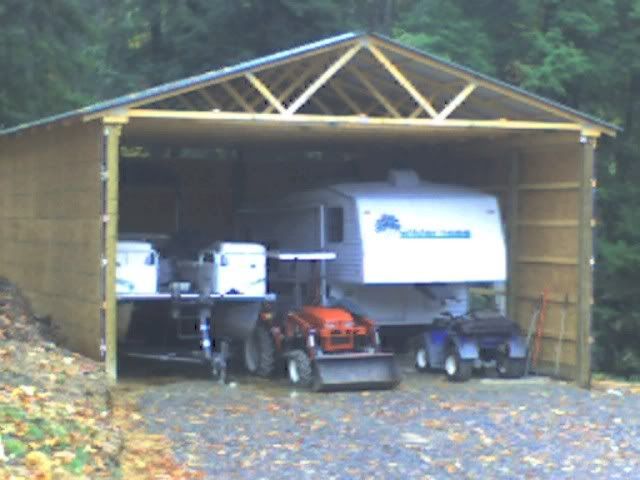

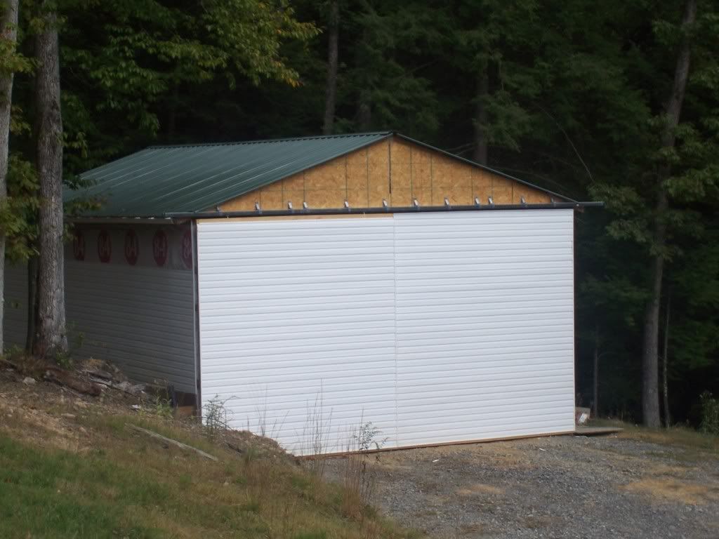

If you have the space this works very well. I built this myself as a pole barn and then added the OSB and siding. I have less than $6500 in materials. For a little more money you can do the whole thing in metal and the construction is much cheaper.
A much smaller version, say a single wide with a 10' opening would be much cheaper yet. This one is 24 by 32 so I could use stock trusses from Lowes and keep everything on eight foot sections. The doors are acutally just a frame with siding attached. I have 4' high sections of OSB on the inside bottom of the doors to put a little ass in 'em when the weather gets bad. The framing keeps them light and the cost down. This opening is 12' 9" high to accomodate the sundeck on my toon (12' 4" on the trailer) but you would not need to build it that high.
Before the doors went on the building.
After the doors and most of the siding. Metal is easier but it we more expensive as I got a smokin' hot deal on the siding and OSB at the time I was building, so I went that route even though it is much more work to complete.
