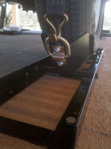

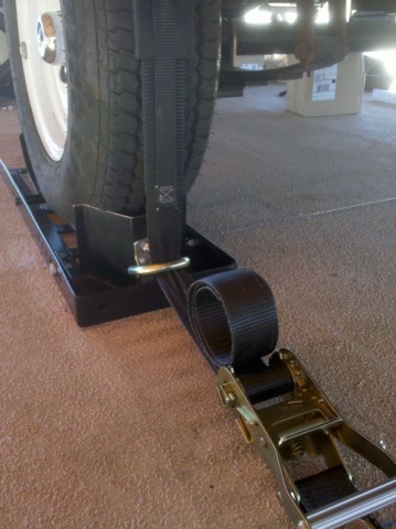

#157 Post by RonKMiller » Fri Mar 18, 2011 7:40 pm
Between the 12,000 lb. test nylon straps, 2 locking wheel clamps, 12 1/2"grade 8 fasteners and all metal locknuts I don't think the trailer will be going anywhere... :smoke
Still working on securing the post up front near the hitch, it only carries about 250 lbs. of tongue weight.

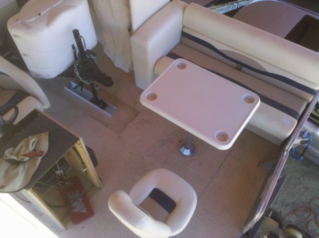

toon furniture installed
#164 Post by RonKMiller » Sat Apr 02, 2011 6:39 pm
Still a LOT of work to do, but I think it will be done in a month... yeah, RIGHT! :prayer

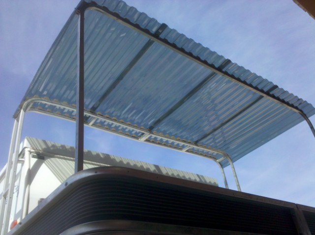

New rear roof made from Suntuf polycarbonate
#165 Post by RonKMiller » Tue Apr 26, 2011 8:18 am
This stuff kicks butt. Rejects 99% of UV rays, is clear and virtually unbreakable, amazingly cool underneath. I chose Solar Gray which allows 35% light transmission since I wanted a "glass roof" feel to my shade cover. Available at Home Depot. The frame for the roof was built from the deck railing and folding bimini shade of the donor Party Hut.
http://www.palramamericas.com/Suntuf
This is the rear roof, the front will be 8 X 10" and also permanently mounted.
