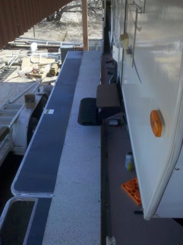

RonKMiller
- Posts: 634
folding catwalk added for door access to trailer
Now we can actually get into the trailer on the starboard side - a rather important thang...
The port side is the same, except there is no walkway (and none needed). If necessary you can "tip toe" along the port side when it is opened.
Also visible in the album are the grab rails I added to the trailer. Note that there has been no cosmetic work done at this point, lots of detailing to follow.
Besides mounting the front roof all of the major projects have been completed. The boat has a valid Arizona registration and has been Coast Guard inspected and approved. It will insure with my carrier as a "houseboat".

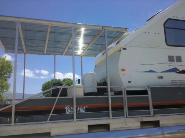

RonKMiller
- Posts: 634
Front roof added
It's hard to believe how cool it is under this polycarbonate.
It feels like full shade, but without the infrared heat bearing down on your head like typical full shade covers. AMAZING. According to their literature it rejects 99.9% of UV radiation. Transmits 35% of visible light. You don't feel like you are in a cave. These pictures were taken at noon in the May Arizona sun - extremely intense.
I came so close to using a sunbrella type fabric instead - even though it can handle intense sunlight Sunbrella is insanely expensive, not to mention the amount of sewing labor involved. It took me about 2 hours to install this SunTuf with a torque sensing drill and neoprene/self drilling sheet metal screws start to finish, and that included trimming it!
I would never even consider a "traditional" bimini or shade roof ever again after using this.
I'm probably going to "curve" the sides down a bit farther in the future (kinda like the rear) since it softens the look and provides even more shade. Oh yeah - it bends.
ENJOY THE FINAL VERSION, STILL NEED TO DO LOTS OF POLISHING AND PAINTING...
