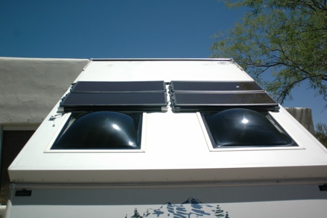

greezzmunkei wrote:Are you going to adapt the boat wiring with the trailer wiring so you can charge the house batteries off the outboard altenator?
I've kept the two electrical systems completely independent.
House batteries are charged by 90 watts of solar power on the trailer's roof, a high quality 1000 watt inverter supplies AC. With just the two of us - and careful management - we've got enough juice to run the stereo all day, and watch a movie at night. Most importantly I can grind fresh coffee in the morning. :coffee For night lighting I generally just use AAA battery operated LED's mounted on the ceiling - although incandescent and fluorescent 12V is available for reading.
Trying to charge up 2 deeply discharged deep cycle batteries for the trailer - and keep the deep cycle topped up for the motor - would be asking way too much of the motor's fairly wimpy alternator.
The only really large demand I'll have on the motor's battery is for the 2 fixed headlights I just mounted: a flood and a spot. There are times on Lake Powell when the ONLY chance you have of going somewhere is to get a really early morning start. Many days, and especially in the spring, the wind can start really howling by noon... you want to have found a great anchorage by then. :prayer
