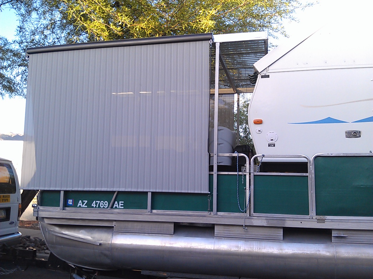

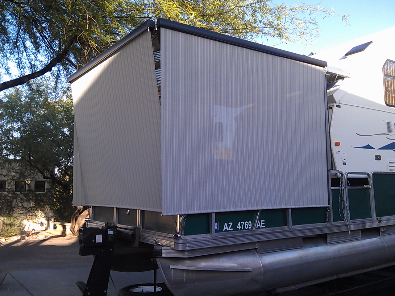

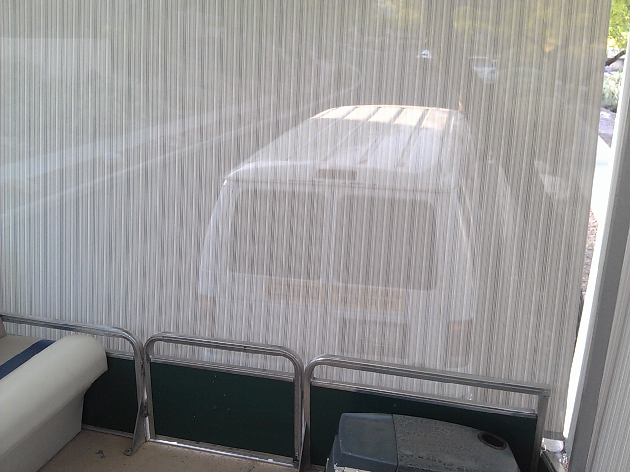

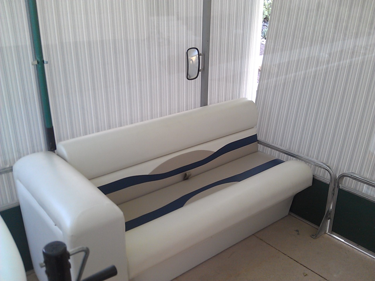

New sunshades installed!

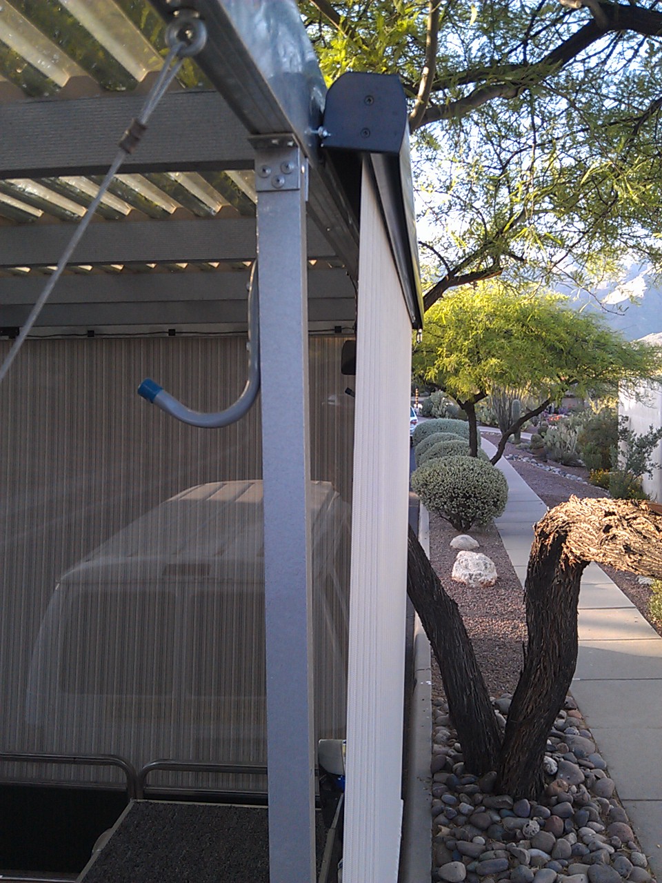

Time for an update. I installed 3 roll up sun shades from Costco. They were on sale for $50.00 each last March so I snagged them, and just finished my installation a couple of days ago.
I had to custom cut the length - which was no big deal - since they don't have a strong "clutch" to keep them from unrolling all the way when blown by hard wind. I used stainless steel tarp springs to secure them with S hooks. The flimsy plastic rods at the bottom were replaced with 1/2" conduit, holes drilled to accept the S hooks and end caps installed to finish them off. I also installed some small eye bolts near the top of the springs to act as "keepers" to keep them from flopping over when not connected.
It's SO nice to have a shady respite from the sun, yet still be able to see out. During the day you can't see in at all, and if you keep the lights off at night you still have complete privacy as well.
The best $200.00 I've spent in quite a while!

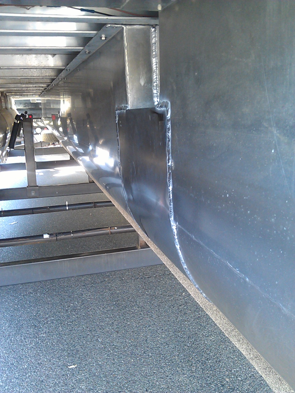

Also time for a new middle log.
My original build - and the junked donor boat - really didn't take into account all the extra weight I would be adding: going from 19 gallons of fuel to 39, carrying up to an extra 500 lb.s of H2O for extended stays, mesquite hardwood for fires - the list just goes on an on. Before I knew it I was a maximum capacity. Never a good idea.
The old middle log had to go. At 18' long and 21" diameter on a 28' boat it just wasn't cutting it. Much to my surprise one chamber was flooded from an already noted previous dent when I bought it. That put me into the negative by about 1K pounds of buoyancy right off the bat - not to mention you are carrying the extra weight of the water inside the log while underway - I estimate another 55 gallons or 456 lbs! There is also the additional drag to consider since water was washing over the middle log (and both side logs) adding yet more drag and weight.
Lady luck smiled on me when I literally stumbled across a 24' by 24" diameter U shaped log at a local boat/rv repair shop. It had just been sitting for a long time - since 1999! The owner was more than willing to dispose of it for a killer price - only $500, and I got $88 in return for scrapping the 18' log. Needless to say there aren't a whole lot of pontoon boats in Tucson, and the fact that this one was EXACTLY the right size was just too much.
What's really crazy is that I was able to extract the old log - and insert the new one - while everything was still on the trailer. It took a lot of grunting since I was doing it by myself, but eventually I had it lined up and bolted down.
The only thing remaining was to find a good tig welder to join the old 21" transom to the the new 24" U log which went well. I fabricated some new "motor mounts" and also a fairing of 5052 aluminum sheet to join the two and maintain laminar flow over the log back toward the prop.
Testing will take place momentarily, but I feel very confident the extra 2800 lbs. of flotation will come in rather - ahem - handy! The trailer alone weighs about 2000 lbs.
The picture below shows the "union" prior to the welding.

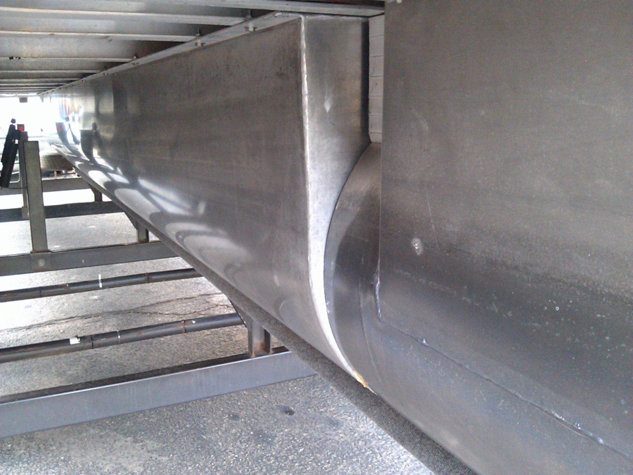

...and the new log welded on...
I decided not to go all the way to the top with the "fairing" - which smooths out the junction between the new 24" u shaped log and the old 21" round log - so that I could inspect the three new motor mount brackets I made that provide most of the strength. There is a curved section and 2 short pieces of angle on both sides hiding under the fairing, you can see the angle at the top. If water does splash over the top of the fairing it drains out the transom.
