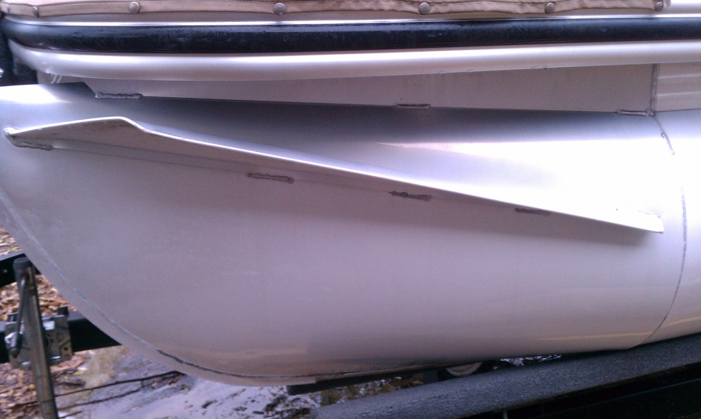

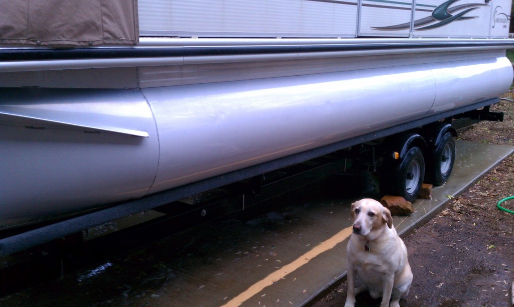

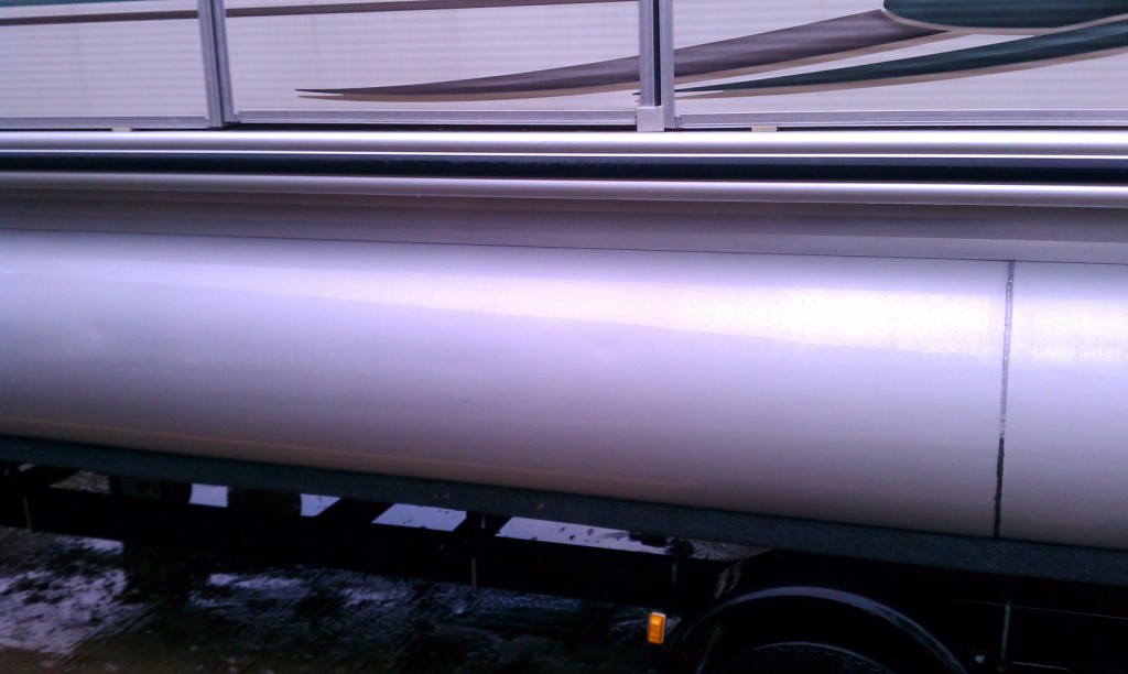

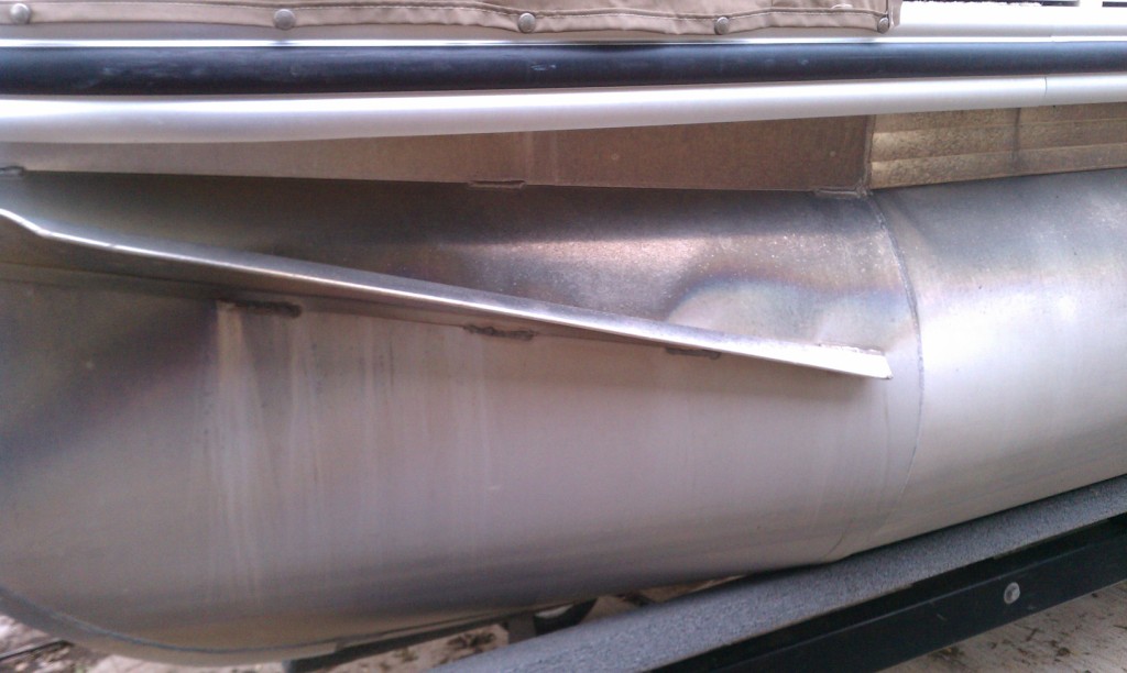

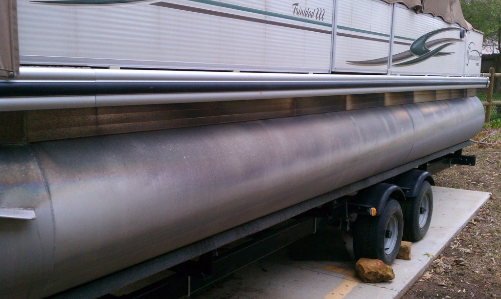

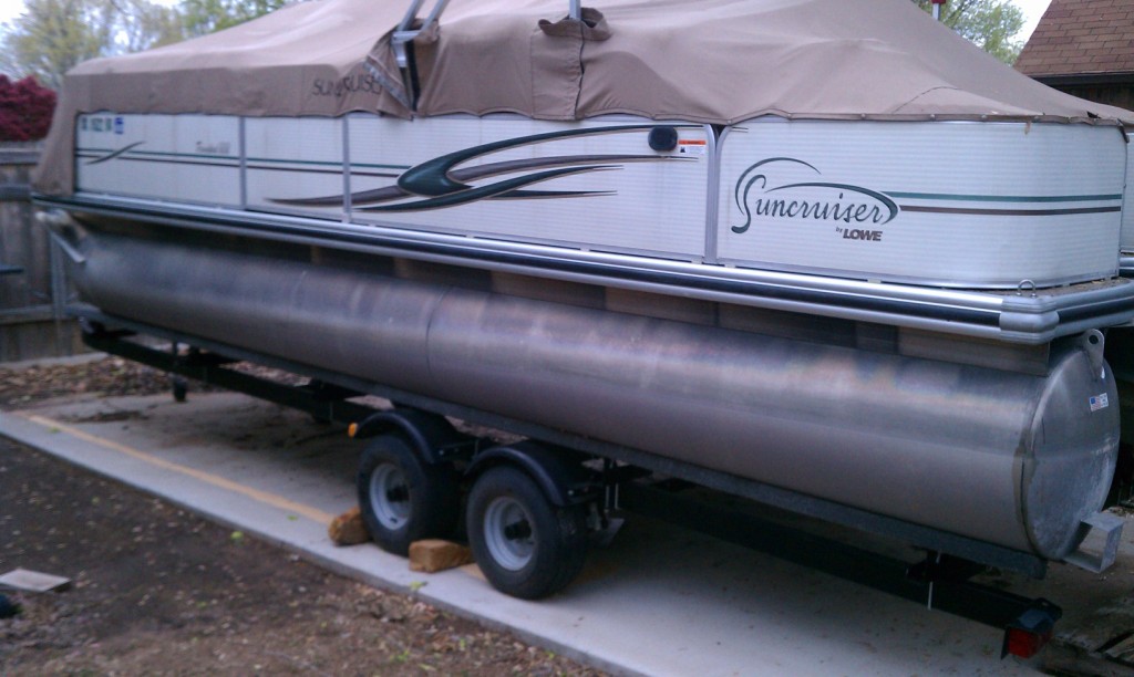

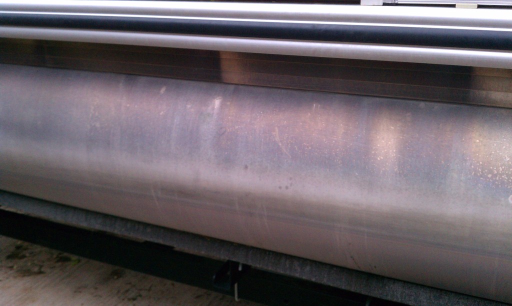

Okay, I'm a believer in this Napa stuff. We bought our 2003 pontoon last year from a guy that kept it in a slip all the time - it had developed a bad waterline and stains.
This stuff was very easy to use -- just spray it right from the bottle, let it sit for 30 seconds and then hose it off. I did 2 applications because the toons were really dirty and stained -- used just about 2 bottles.
Here's some before and after pics. In the "after" pics, you can even see the reflection of the yellow line on the ground.
- closeupbefore.jpg (116.93 KiB) Viewed 6190 times
- before1.jpg (131.91 KiB) Viewed 6194 times
- before2.jpg (114.05 KiB) Viewed 6191 times
- before3.jpg (144.23 KiB) Viewed 6188 times
- after1.jpg (106.46 KiB) Viewed 6190 times
- after2.jpg (111.5 KiB) Viewed 6185 times
- Isaac making sure it all looks good.
- after3.jpg (136.29 KiB) Viewed 6178 times

The Napa product does leave them dull. I didn't notice any chalky residue. I wasn't looking for mirror finish though. I just wanted the toons clean without the black stains and streaks. Up close you can see blotches but from a distance, it looks great. It made the 2003 toons look much newer.
