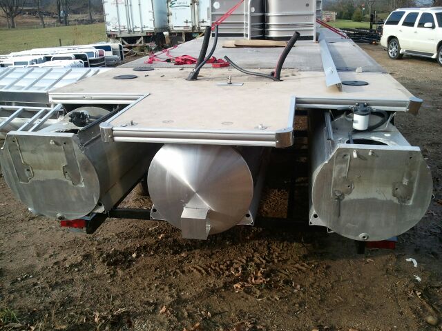

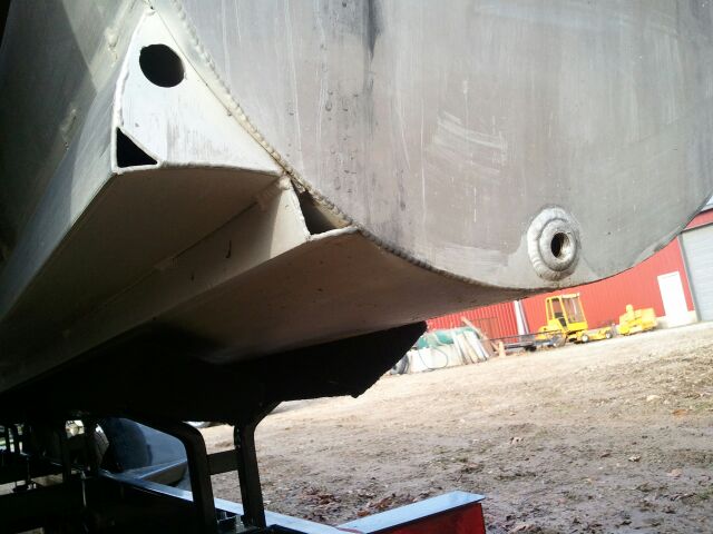

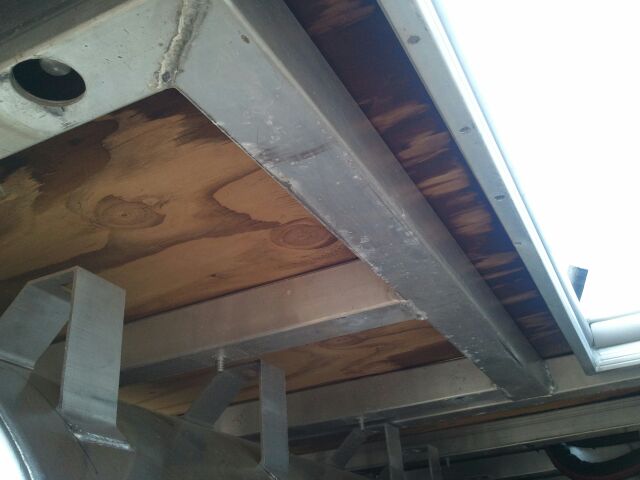

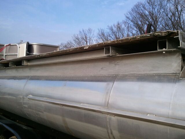

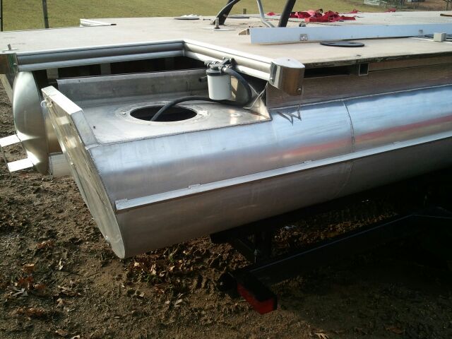

OK, so I kinda forgot about this thread till me & my buddy were talking today. Here is what I came up with. On this particular model the side "keel" on the outside tubes does not go all the full length. I'm guessing that's an option, but some in the rear is standard. This one also has an additional keel welded just inside the strakes on the outter tubes, full length. Looks like standard 16" O.C. spacing for the cross memebers, and the fully welded rear sub floor (all South Bay TriToons have a welded rear sub floor). If you look at the one side shot with out the rub rail you can see the solid tube running rearward from front to back. That is where the full welded rear sub frame starts. Check the photos...
