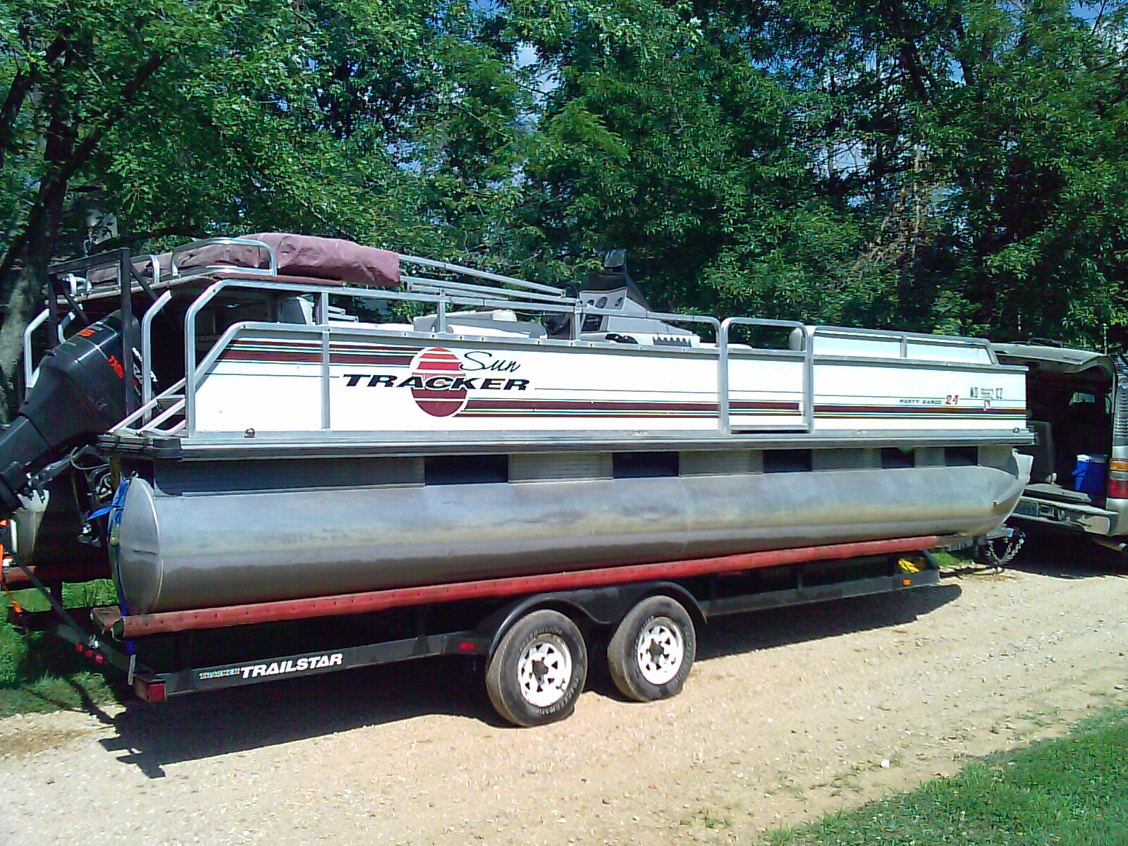

Buying a pontoon with a Mercruiser 3.0
Re: Buying a pontoon with a Mercruiser 3.0
waterline looks right to me. standard operating procedure--women up front, guys near middle,
captain in back--it evens out the draft. waterlines are draft with no one onboard.
we pull two or three kids on skis, or one adult on skis, or two kids on wakeboards,
or one, two or three tubes. never a problem. except that our 28' toon doesn't turn
around so fast to pick them up, so we stay away from really crowded lakes.
1) When was the impeller changed out, if at all?
Original boat has only 70 hours
--supposed to change the impeller every two years. it is a function of years,
not hours. sitting over the winter tends to put a set into the rubber blades
which then shred and clog up your cooling system. never ever ever ever
run it without earmuffs attached providing water.
2) What condition is the exhaust flapper in? Has it been replaced?
See number one
-- have it checked. you can run without a flapper but if you stop fast and a
wave hits the stern, it might push water into your engine and ruin it.
3) Does the boat come with a transom saver (either webbing or solid
bar) for trailering?
Yes solid bar transom saver
-- good
4) What are the numbers on the compression test on the cylinders.
Never been checked, has less than 70 hours
-- if it was me, i'd have it checked. i'd do it myself or pay a mechanic of
my choosing to do it. don't trust the dealer. don't trust his mechanic.
5) Could you tell me what the runout on the prop is?
Depending on condition and load approximately 25-30mph
(I don't think he understood what I was asking - hell I really don't myself.)
-- no, he doesn't get it. you take off the prop and use a dial indicator to measure
how much wobble there is in the prop shaft when it turns. merc has a spec on that.
if it's outside the spec, there was a prop strike that bent the shaft and maybe
damaged the gears. i really doubt there's a problem, but if there is it will end
up being measured in thousands of dollars.
6) Is the prop aluminum or SS, and how many blades and what is the pitch?
Aluminum three blade, pitch 15.25 x 15
-- hit an aluminum prop, break the prop.
hit a stainless steel prop, break the gears.
props are cheap compared to gears. aluminum is good.
my boat does best with a 3 blade aluminum. it took about 4 props to find the
right one. i was able to buy them used from a local boat yard and sell them
back if they didn't work well.
7) When were the fuel filters last changed?
End of every season. They're fresh.
-- i change my fuel filters in the spring, when i change the plugs.
after running it and burning off the fogging oil. sometimes you can
get water condensation in the fuel tank over winter. maybe it could
bring some dirt in with it, i don't know. makes more sense to me to
do it in the spring.
8 ) Does the engine have hydro steering?
Yes,
-- nice. we don't have it and you can feel it. not a big deal, though.
9) This mercruiser has the TKS carb on it, correct?
no
And then on the trailer - how old are the tires and do any of them
have cracks?
Original tire with less than 20 miles on them and has been stored most of
its life. We ordered you a new spare for the trailer.
This is a custom made trailer for this boat by tracker with dual axel brake
system.
-- those tires are probably dry rotted. i wouldn't trust them. i buy my trailer
tires at pomp's because i can get a load range D tire. do not run with a light
load range tire. you will blow one or two and then you've got trouble.
i think you want to pack those trailer bearings before you haul it anywhere.
if they are surge brakes you'll hate 'em. well, i hate 'em. some day i'm putting
on electric brakes.
ask lakerunner to email you his private collection of pics from his parade.
he's very proud of them.
fb

I'm almost as new to tooning as you are, but I feel like a veteran after all the knowledge I've gained on here from these hooligans
As far as the trailstar trailer with surge brakes mine is the same and its a 94.
I only tow 10 miles round trip so I don't notice any issue with the brakes.
That makes two of us computer geeks.
Have a safe trip weather should be good. We are going down to check on boat, clean new trailer, and burn some leaves on the lot. If you see a big ass fire north of 44 around Springfield you know I had too many.
I told you this was the site for all your answers!
- IMAG0043.jpg (623.69 KiB) Viewed 6052 times
