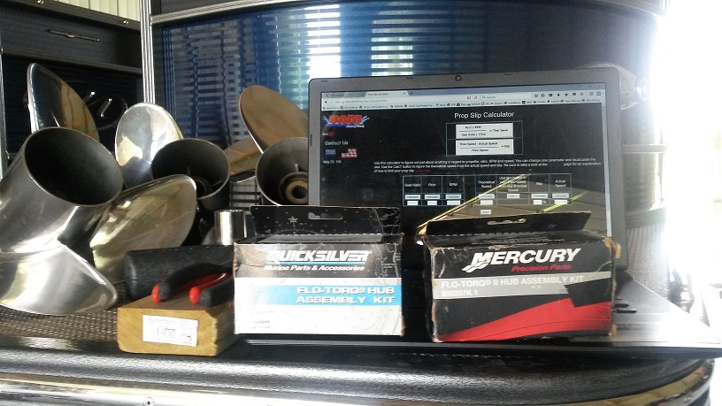

Getting ready to prop the new Manitou. I have 4 props to try, after raising the motor 2 holes. Here's what we have to load. Props, adapters, torque wrench and 1 1/16 socket, extendable magnet, needle nose and side cutters. Chunk of 2X4 and the holy grail of prop testing... The Prop slip calculator!
Water is too cold for deep water swaps, so I'll have to beach and spin...
Fun Stuff!!! Really!

GOOD LUCK!
