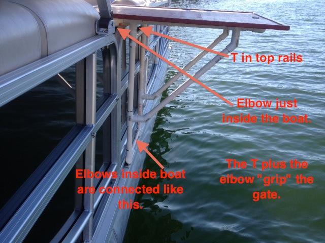

I like your setup for your grill. How do you have the brackets setup for attaching it to the side rails? Thanks.

It's a pretty cheap system, firedog. This picture will help a little along with the explanation I'm about to give.firedog wrote:woolznaz
Think of it as a triangular right side frame, and a triangular left side frame. These two frames store separately when not in use. Each side has a few points, or "T" joints where I can slip PVC pieces in to slip the contraption together when in use, but break it down when stored. Just like any PVC male/female connections, but I just do not use glue on anything that connects the right side to the left.
Now, to your question about attaching to the rail. It just basically "grips" the rail or fence.
In this picture you can see I have a "T" in the left and right top (horizontal) supports. That "T" creates the legs going down (vertical). You can actually see that T goes directly into a sideways T and that sideways T provides another point for the left and right sides of this contraption slip together as described above.
Follow the vertical PVC down and you can see gravity holds it down as it sits on the aluminum deck just outside the fence. What you cannot see is that the horizontal support (the top support) goes a couple inches past that top T to extend the top support inside the boat. It continues just inside the aluminum rail on the top of my fence. Once it gets inside the pontoon's rail or fence, there is a 90 degree elbow bending it down. That 90 degree elbow and the T are just far enough apart to "grip" the aluminum rail at the top of my gate. That grip keeps the entire thing from falling into the water. I allowed room to wrap some foam pipe insulation around the inside vertical part (the elbow you cannot see that is just inside the boat) to get a better grip on the fence.
Just inside the rail, where that elbow bends it down on both the right and left (separate) triangular frames, is another point where I slip a connecting PVC piece in to connect left and right sides when in use.
It's light, cheap, breaks down and sets up in about 2 minutes. You can engineer something better very easily, but this was how I did it.
