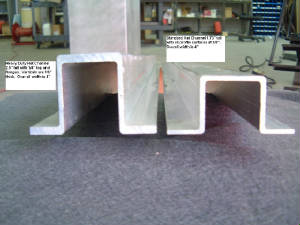

#38 Post by RcgTexas » Sun Jun 14, 2015 3:05 pm
I hesitated to post about this because I could NOT see what the problem was. Now that I have seen the pics and the discussion, that scares the crap out of me!
Here is a pic of "Hat channel" that I bought to rebuild my boat. The one on the left is what I used, Its 1/4 inch on the flats and 1/8 on the verticals and it is extruded , not bent.
