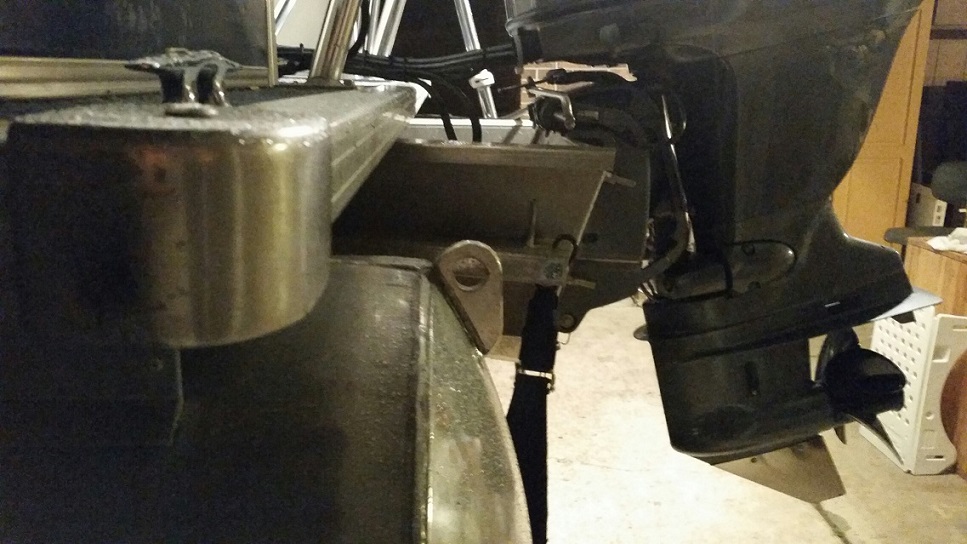

Here is a pic of how my motor sits.

Personally, I would go with the one with the motor mount. I don't see drilling the motor mount holes being that big a deal. I would check to verify the price difference of shipping the two sizes, could be a game changer, but I would make sure before deciding.
