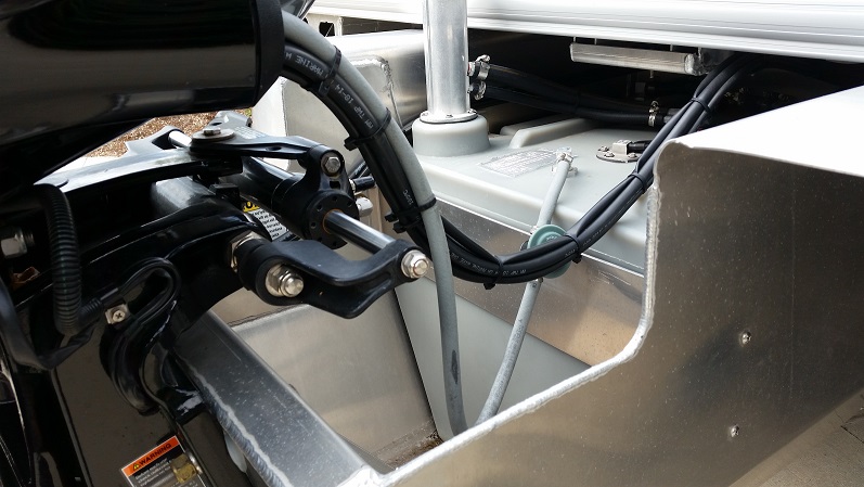

there are more issues than just hooking up. The current transom will not allow for tilt more than 30% and will not allow the motor to sit lowered all the way. That is why I engineered the new arms for the steering. Now tilt is 80% and the motor is at the bottom......but that was a FIX not a solution and it still caveated. The 15' boats come with a re-engineered transom that lowers the motor 4-5 inches and allows for 100% tilt. Obviously this boat was not the only one with this issue or they would not have created a re-design of the pod.

So I called Tracker and opened a service issue. I'll post the results when I find out what they intend to do to rectify the problem.

Well, heard back from them.....they are cutting the V fin off the current transom and adding a 4 blade spitfire prop. Should know how this works by Monday. Pretty sad that a company this large just doesn't say " here's the 3rd pontoon your missing with the updated transom...thanks for the 40k"
but I guess you have to follow protocol. This will be the last attempt before all hell breaks loose.

HAHAHA!!!! well, I can't cut anything off that's for sure. If I cut the transom they would say....warranty void. They can do what ever they want as long as it gets fixed and doesn't cost us money. Hope this works. Getting sick of this broken boat stuff. They are still saying that being able to raise and lower the bow with the trim is not a concern, not all boats(with 2 pontoons) can raise and lower the bow. I find this hard to believe. I know others with tracker pontoons with serious power almost blowing over backwards.

So the Spitfire prop did not arrive for the weekend but I was able to use the boat with the V wing cut off from the transom. No cavitation. The current 15X15p prop is too large as the WOT is 5100rpm. I hope the Spitfire raises my Rpms, or it will be a re-propping issue. They actually raised the motor by 1 hole after the wing removal. Thanks to TLOWRY for the advice, I couldn't cut it because of warranty, but they could. Ill let you know what pitch gets me 6k rpms.
