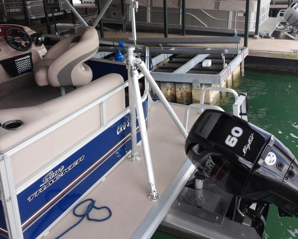

I'll have to argue against that rule of thumb... I see many factory boat mine included that the railing and furniture alike go past the nosecone weld line. Two toons that tie up next to mine are more fish buggy style and have railing even more forward than mine. Blow the pic of the tow bar up and you can see the boats I'm talking about. But as the OP has already commented his design contributes to nose diving if not properly ballasted; and some weight in the stern by way of a bigger motor will go a long way to righting the wrong...

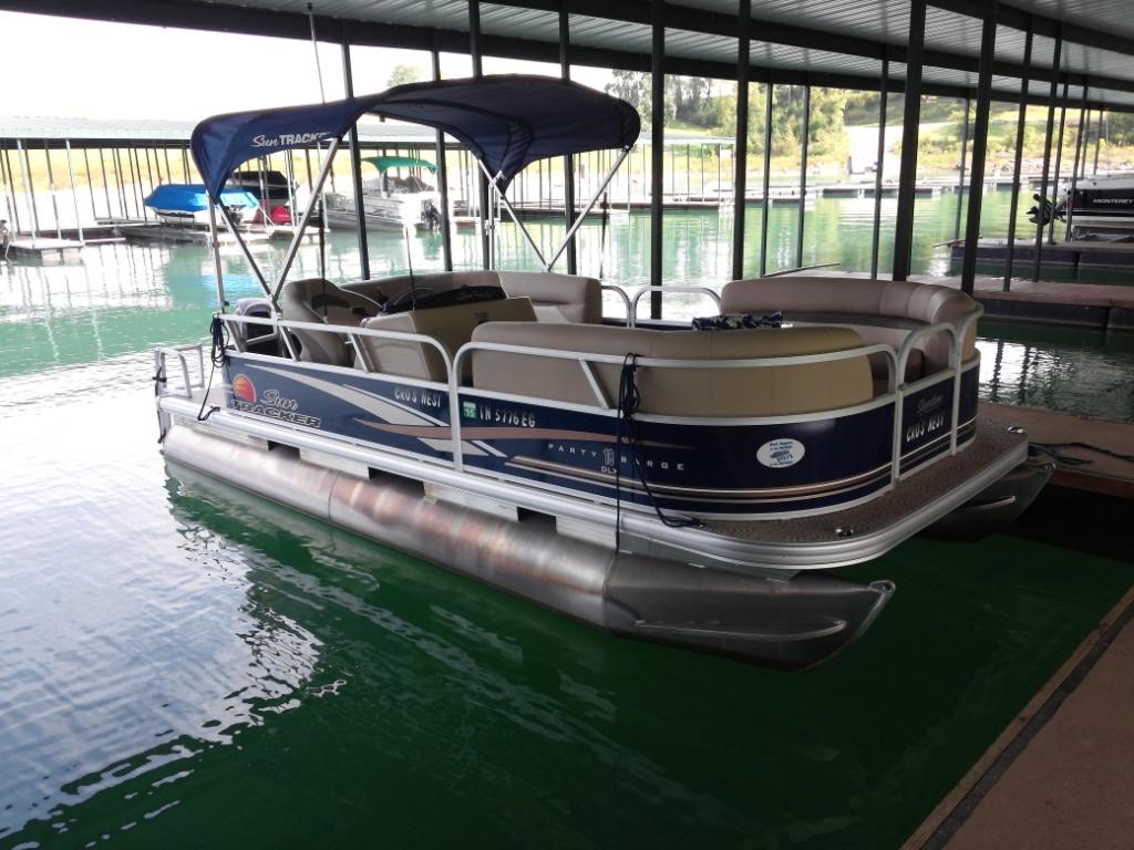

I had to read this a couple times over but I think he is saying that she does sit a couple inches deeper by the stern... I've included a pic of my own for comparison.

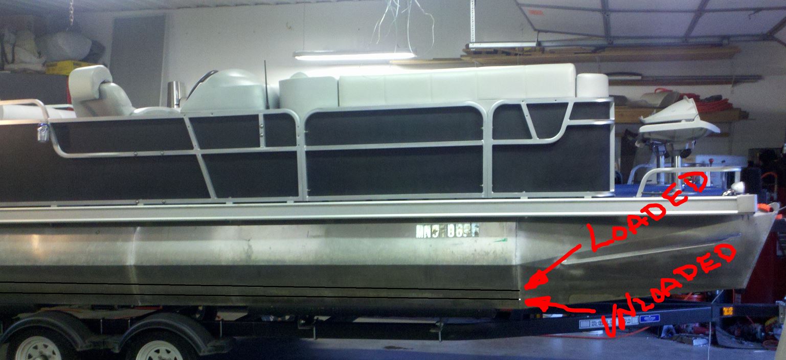

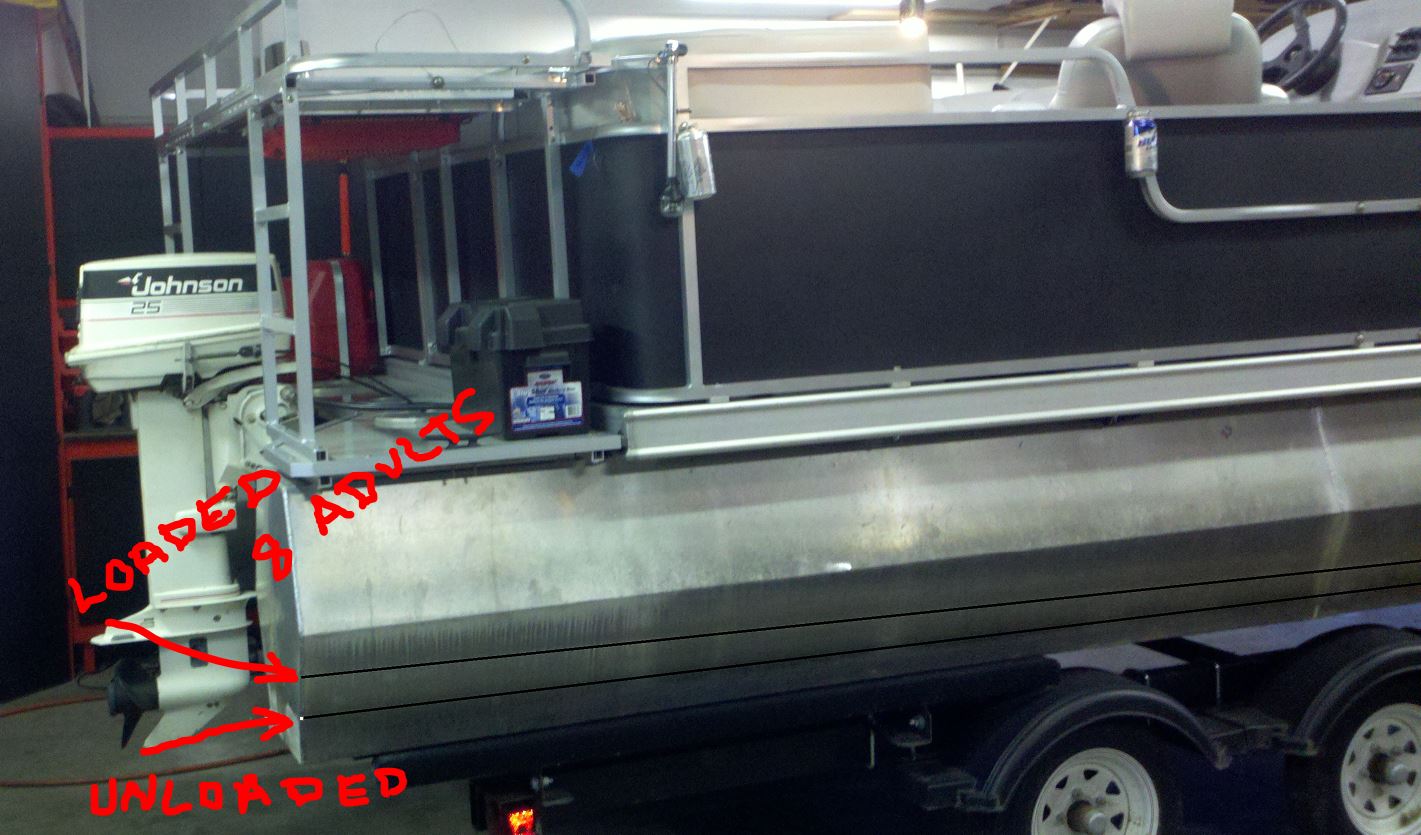

Maybe I should rephrase this, doesn't make much sense. The back sits lower in the water than the front. pics below shows loaded (top line), and unloaded (bottom line).
12 gal gas tank located in the back. One battery located in the back, and one located in the captains council.
Yes the front extends past the nose cone weldment. We do not use the front two seats when the motor is on. and only sit in the front bench when idling around.

Move the battery somewhere else and double up on the amount of fuel you carry at all times...
I'd be looking for upwards of 24 gallons or more!

teecro wrote:Move the battery somewhere else and double up on the amount of fuel you carry at all times...

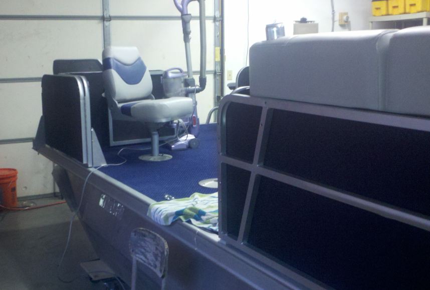

Ya, I could move both batteries under the center rear bench seat and add another 12 gal tank. I would like to keep the center of the rear deck open to store my two seats. During my rebuilt I flipped the railings from front to back and added a 4' extension. The one side has a 4' door along with the 20" entry door that opens up providing a 68" opening, so my pooch can hang out the side and watch the fish when we are moving, and not be in the front hanging over the edge. So I move the two seats to the back deck under the sun deck. This gives us a nice big swim play area.
