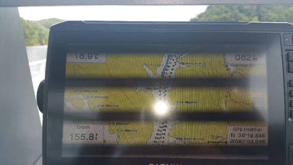

1st off original data was knots not mph, I switched my plotter to mph for everyone else and we say 9-ish mph at
5500 rpm with old 3 blade prop, this morning me and my buddy fired boat up and backed into the ramp at marina we are using, borrowed a 2x4 and swapped prop to the 4 blade I got. 10 min later we fired up and pushed off
WOW at idle almost 3mph and smooth, we got gas and went out..
Brand new boat, 19 mph at 5200 rpms and cruising at 15/16mph at 4200 rpms, totally different creature
At 16 mph we can actually talk!
Love it, need to lower engine about 2 inches this winter when I rebuild transom
End result?
2 thumbs up
Sorry for crap screen shot....
2018-09-14 12.52.19.jpg (114.85 KiB) Viewed 2055 times
