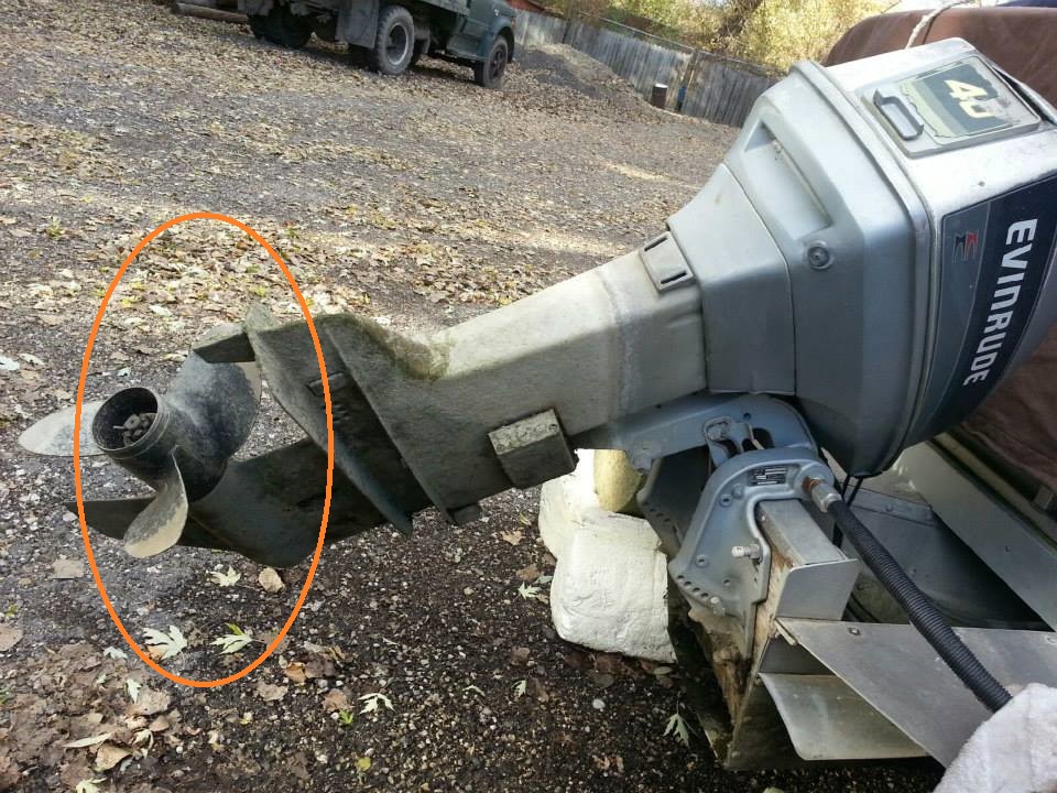

I'm under the impression that you live in a cold climate also. Anyway everyone I'm aware of in my area either stores their boat with the engine trimmed down or if that is impracticable they securely bag or waterproof the lower unit. See orange circle.
The reasoning is that water can and will accumulate in the exhaust area behind the prop. The potential of the freezing and thawing of this water over the winter creating damage is real and easily prevented. So if you can't trim it down for storage find a means of removing any water already accumulated and seal it up watertight and potentially save yourself some grief and $$ come spring.

#54 Post by curtiscapk » Wed Oct 30, 2013 4:29 pm
or cover with a bucket and strap it! I put mine up on the transom saver. So that weight isn't pulling on the wood for 6 months without moving.

#55 Post by katieclooney » Wed Oct 30, 2013 5:06 pm
Thanks for the tip. Ill trim it dowm when I go Sat to wash her. That is the way they had winterized her.
