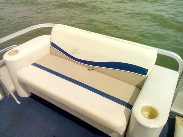

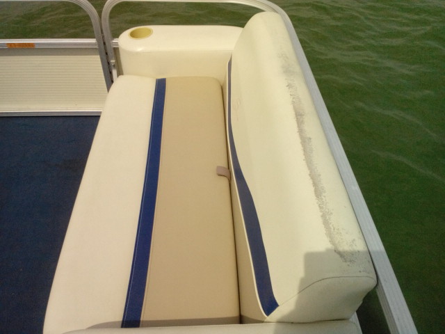

Thanks - We are really enjoying it. Still need to work on cleaning the carpet and seeing if we can clean the mildew (?) stains on the top of the seating.

Anyone know if a cleaner is available to clean what looks like mildew stains off of vinyl?

A. Medium-soft brush, warm soapy water. Rinse/Dry
B. One (1) tablespoon of ammonia; one-fourth (1/4) cup of water. Rinse/Dry
C. Bio Kleen Amazing Vinyl Cleaner. Rinse/Dry
1. Dish Soap (Dawn, Ivory)
2. Bio Kleen Amazing Vinyl Cleaner
3. 303 Aerospace Protectant

Most welcome... Amazing from Bio-Kleen flat removed some mildew out of pebble-grain vinyl that laughed at the cheap dollar store stuff and even ignored 409 with Bleach cleaner...

Should work as it does seem to be a quality name brand product designed for marine vinyl use... The biggest factor to keep in mind is "moderation" in that you don't want to use any more harsh chemical than absolutely needed to remove either the dirt, stain or mildew from your seats and then to protect them to prevent the return... Just like the use of the magic eraser will it work? Absolutely it will. But over zealous or frequent use can remove top coat and leave you open to stains that will penetrate and not come out... I do a lot of my general cleaning with a soft terrycloth towel and water, when/if that does not work I'll add a mild soap to the cleaning routine... And keep the seats well lubed up with 303 Protectant and most dirt never sets in...

Thanks guys. I appreciate all the input. Since the seats are still soft - even the stained areas, I want to make sure I don't do something that strips any protectant that starts major decay. It's not a new boat, but the previous owner seemed to have done a nice job and I want to keep it that way as long as possible, too.
It looks like I should have some UV protectant before I go too far cleaning.
