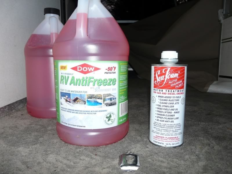

1) To begin, I usually add Seafoam to the tank a few trips before we take the PC out of the water. If not done then, be sure to add stabilizer to the fuel and run the motor long enough so that the Seafoam gets into the carb.

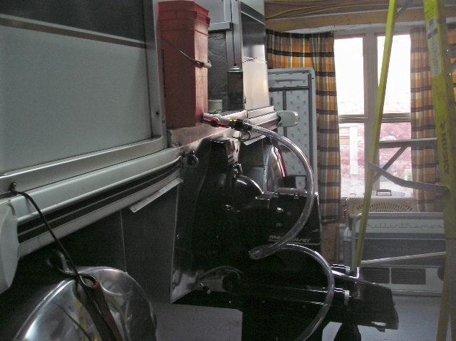

2) Hook up a suitable "boot" to your garden hose(turn on the water!). Start the motor and warm it up until the thermostat opens (I wait until the temerature guage reads 165).

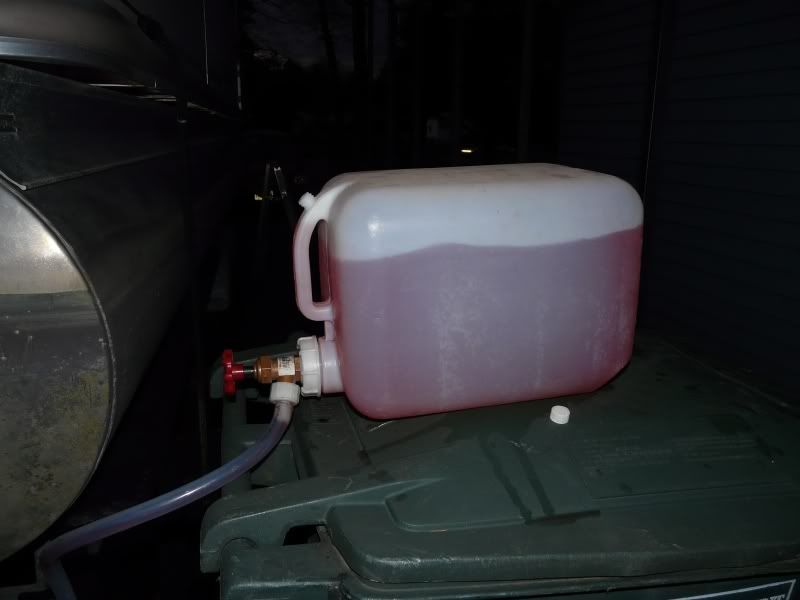

3) Remove the garden hose from the boot, and hook up the winterizing kit (tank, hose, fittings) as shown below. Elevate the tank so it's above the drive water pump. (Yeah the logs, drive, etc are dirty :puke ...just pulled it out of the water. I use 4 gallons of the pink RV/Marine antifreeze. Run the motor until you see the pink antifreeze coming out of the exhaust ports. Leave about a gallon in the tank.

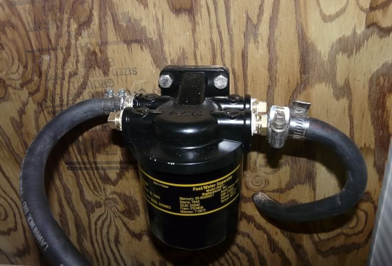

6) Change the water seperating fuel filter element (if equipped), Fuel pump bowl filter and carburetor inlet filter.
Water seperating fuel filter:

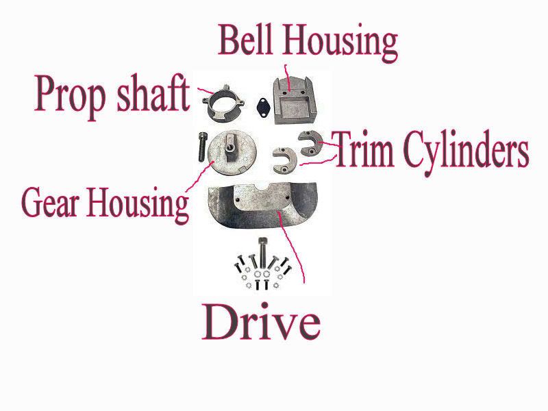

8 ) Inspect the drive's anodes and replace any that are 50 percent deteriorated. Alpha One Gen Two anodes are shown below:

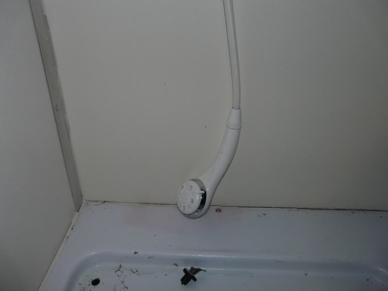

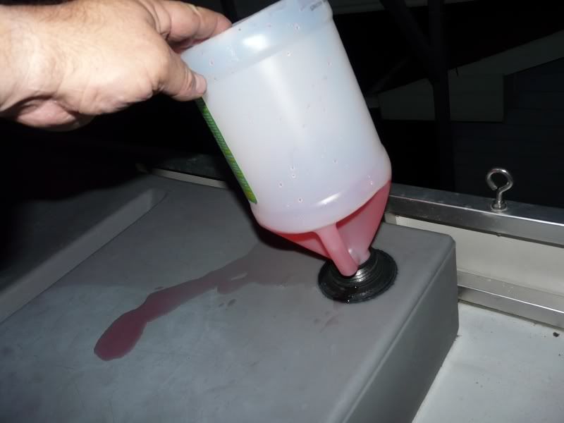

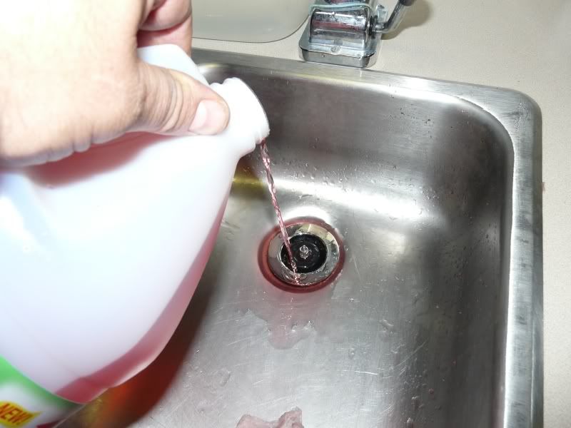

13) The Party Cruiser has 4 water tanks. (2 two supply tanks, and two holding tanks). I drain them all and add 1 gallon of RV pink antifreeze to each supply tank and 1/2 gallon down each holding tank.
I open the water valve and lower the showerhead until antifreeze is present.
One gallon down the sink to protect the galley holding tank, another gallon down the shower to protect it's holding tank.

I know it's an old thread but I just made this out of a square plastic bucket I had. Drilled a 1/2'' hole in the bottom and bought about $10 of fittings including the ball valve using garden hose washers on each side. I already had the clear 5/8 hose. The bucket fit tight under a bracket like it was meant to be there.

As much as I liked the bucket mods, I liked the antifreeze setup BMR used...where can I get one?

playcat wrote:As much as I liked the bucket mods, I liked the antifreeze setup BMR used...where can I get one?
I use one also. They work great.
http://www.westmarine.com/webapp/wcs/st ... sNum=50297
