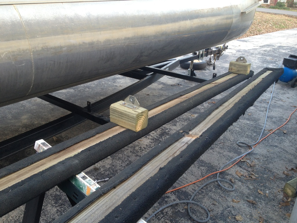

Didn't realize I hadn't updated this thread, so here goes.
As far as the overall ride, WAY better. The boat sits much higher in the front, obviously, so it takes large wake like a dream. I was out Sunday in 20knot winds and it had the lake capping with 3-4' rollers. Bass boats were having a hell of a time, I saw a few go almost 90* vertical, but I could run full throttle drinking a soft drink. The rollers were just close enough together for the old girl to crest each one... thing of beauty I tell ya.
Speed: Very disappointed that it didn't give me anything, not only that, it actually cut 2.5-3 MPH off my speed. But I think with a full load of people, the way it rides in the front it will actually even out.
Trailer issue: I used 4x4 blocks to space the bunks. I jacked up each side and that made it easier to install them all. The problem is I didn't take into account the placement when angled, would change so much, so I need to readjust where I attached the brackets to the 4x4 this weekend. It's causing issues when I load the boat each time, often tilting the bunks off kilter. Simple solution, just time consuming.
