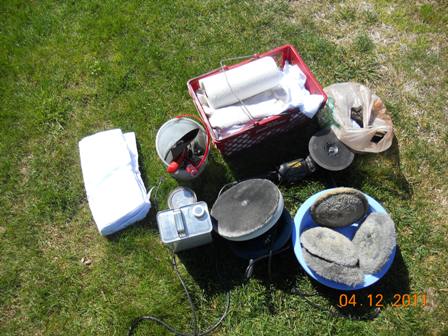

- Tools to be used for the job!
- premierpolish 004.jpg (104.2 KiB) Viewed 14301 times

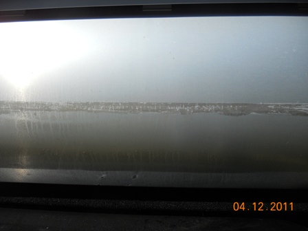

- Dock Rash! This has to go. Time to roll up the sleeves and spend a few days polishing.
- premierpolish 001.jpg (99.35 KiB) Viewed 14292 times

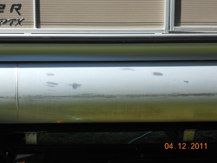

- Wet sanding the Dock Rash, left behind by the previous owners docking technique. If you hit it, your there! Not my favorite way to do things!
- premierpolish 002.jpg (100.05 KiB) Viewed 14299 times

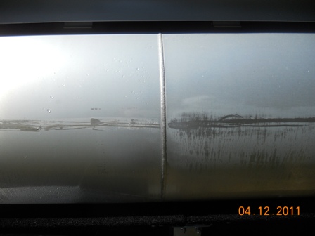

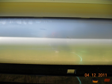

- After wet sanding the nasty dock rash and removed slag. Ready to use the Cleaner to etch the aluminum.
- premierpolish 003.jpg (105.86 KiB) Viewed 14287 times

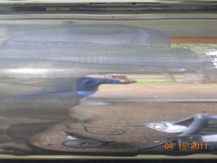

- Working in a from the top-down "S" motion in a 3 to 4 foot section worked the best for me. You can the difference with every pass of the buffer.
- premierpolish 008.jpg (113.78 KiB) Viewed 14265 times

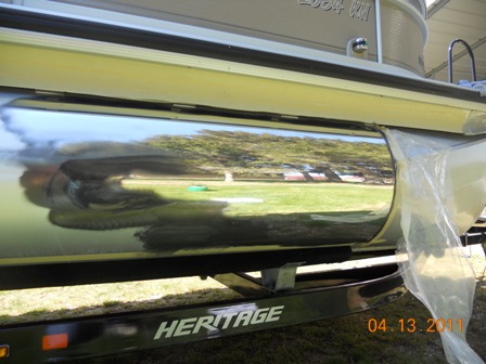

- After polishing is done. Remove all left over compound by using Lacquer thinner on rags. When no more black is removed, its clean and ready for Sharkhide Protectant.
- premierpolish2crop.jpg (159.13 KiB) Viewed 14230 times

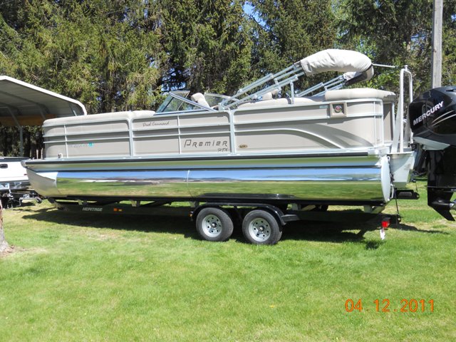

- Apply the Sharkhide using a a rag. Pour it on, and swipe it on a 6' section, side to side motion, from top to bottom. What you miss on the first coat, will be hit with the 2nd or 3rd.
- premierpolish1crop.jpg (162.63 KiB) Viewed 14252 times

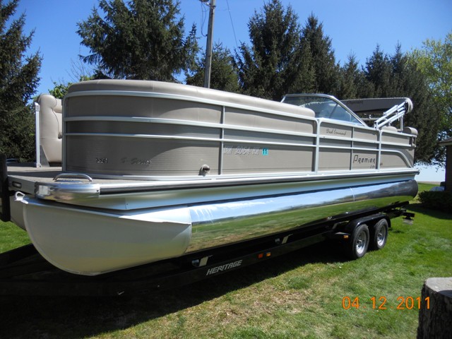

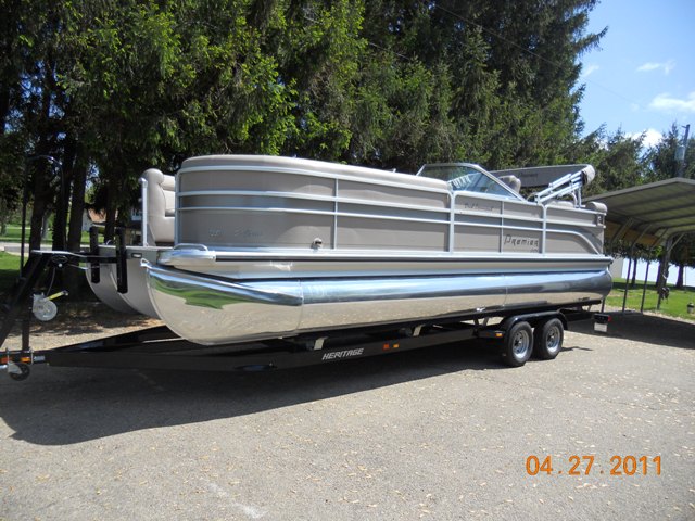

The outside pontoons are done, took about 4 hours to do the outside and top of each nosecone. Both of them have 2 coats of Sharkhide. I will start the insides of the outer and center nosecone tomorrow and then try to get the transom and rear caps done on Weds. Then afterwards, everything gets the final 3rd coat of Sharkhide.
Also got my Registration Letters, all done in custom chrome to match the Premier lettering. Will get pics of that to ya as well!
Need to change the date on the camera, too. Wish it was 2011 again.
- premiernc4.jpg (154.2 KiB) Viewed 13681 times
