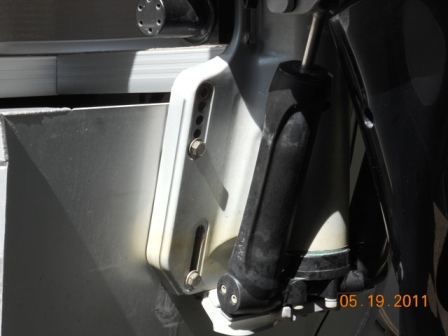

Trying to determine if my outboard is mounted at the optimum height for best overall performance. Boat is 2008 Sun Tracker 21 footer with NV logs and a Merc 90HP four stroke. Currently with the boat sitting still, there is 7" of distance between the cav plate and the water surface.
There are 5 mounting positions available, 1=lowest and 5= highest. Mine is currently mounted in the #2 position so there is room to raise it if needed. How to I determine if the outboard is mounted in the optimum position?

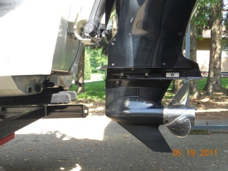

Hmmm...jimrs wrote:Your cavitation plate should be about even with the bottom of the poontoon.
All I have right now to look at is this pic. It appears that the cav plate is much higher than the bottom of the toon.

Yours is mounted just like mine. The service manager that rigged my boat said that was where Sun Tracker recommends it to be. You want your cavitation plate even with the bottom of the motor pod not the pontoons.

Here are some pics of where mine is at now. It runs like a different boat.
- raised1.jpg (110.65 KiB) Viewed 8393 times
- raised.jpg (114.89 KiB) Viewed 8397 times

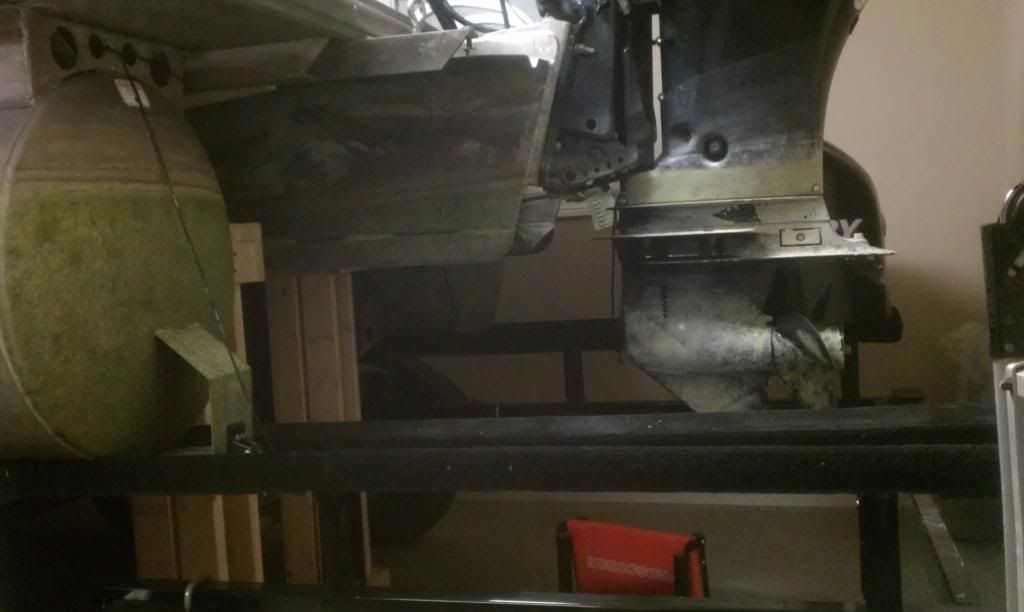

Please check my outboard height position.
I can easily raise it f bolt positions.
Comments?

You already have the fastest running 90 hp pontoon on earth @ 36 mph.
If you're not having any cavitation problems in turns (after trimming the engine down slightly) and if you're capable of pulling the redline, you are at the optimum height. Speed tells.

I don't think there is one set up that works for every boat even the same model. Just the difference of how you load two of the same boats will change the set up. It won't hurt to raise it up a hole and see how it performs. Keep going up until you start slipping to much. Trial and error is how I have always done my height settings. It sounds like you are doing well right now with the way it's set up. I would think you stand to gain more by cleaning the logs ,transom , and lower unit . From that pic it looks like you might have a fair amount of drag there.
I always liked the n.v. logs and how well they seemed to work. I remember seeing a video with 2 matching boats, one with the strakes and one with out. They were only running 60h.p. motors and what a difference it was. It sure blew the theory of a 100+h.p. need to get a boat up on strakes !!!

From your last pic, it appears that your motor is about 2" lower then mine. I also noticed from your waterline mark on your toons that your boat sits quite a bit lower in the water then mine. Do you have any extra weight in the stern? Also I agree with above post regarding the neeed to clean all the scum. That could easily cost you 1 mph or more.

The boat is going to get a good cleaning and with the new dry dock storage, growth will never be a problem again.
Brumbyvet,
I dont have any significant weight in the rear, but I think I am going to raise it a hole and see. Maybe I should lose some weight. LOL
