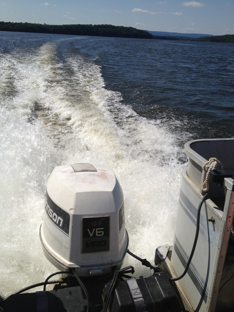

Re: Might have fried the Honda :(
A moving shot from a happy boat owner.
Those old OMC's were notorious for gulping gas but they ran strong.
My buddy had a "two thirsty five" that ran great but the fuel was killing him. He bought a Yamaha 250 2s and cut his fuel consumption by a third, going faster.
