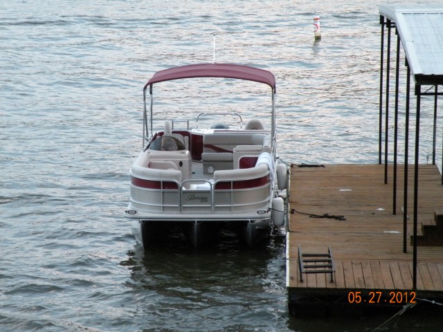

- The aft view.
- new boat (18) (Custom).JPG (105.08 KiB) Viewed 4712 times
