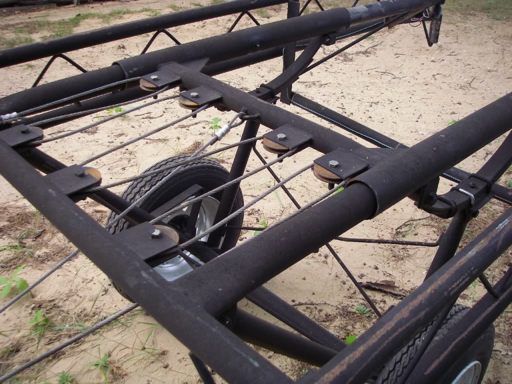

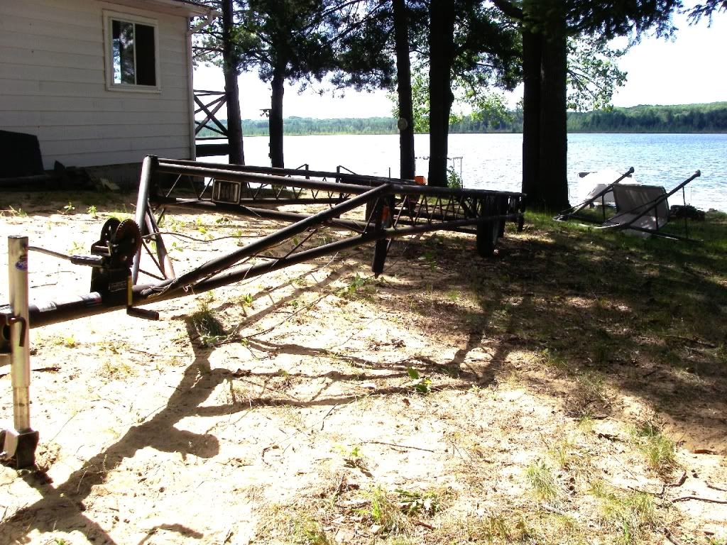

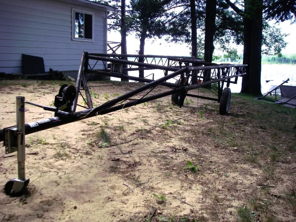

I finally have some pictures and this is a strange trailer
It's a 2000 Hoosier and they still make this type. The sliding tubes are attached to the axle rear struts so when the tubes slide back the strut allows the axle to tuck up inside the rails. Gets very close to the ground. I'm guessing here since I have zero experience but by only lowering the rear this only adds to the ramp angle--making the rails pretty steep relative to the boat. Not sure if that causes retrieval problems.
Mechanism:
Up:
Down:
Mechanism:
Up:
Down:
