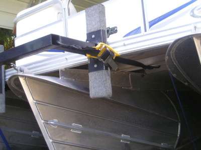

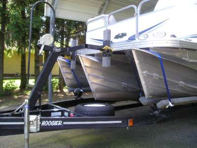

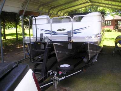

Found it! These are pics of my old Manny from the Boating World article. I rig the Premier the same way. Next time I get the Premmie ready, I'll get some pics.
Hope they help!
Bryan
Hope they help!
Bryan
- From the back
- straps 004-400.jpg (20.31 KiB) Viewed 8858 times
- From the front
- straps 002-400.jpg (18.93 KiB) Viewed 8853 times
- Straps from around the tops of the nosecones to the bottom of the front of the trailer
- straps 003-400.jpg (19.68 KiB) Viewed 8854 times
- Straps around the front supports to under the bow platform
- straps 001-400.jpg (13.52 KiB) Viewed 8855 times
