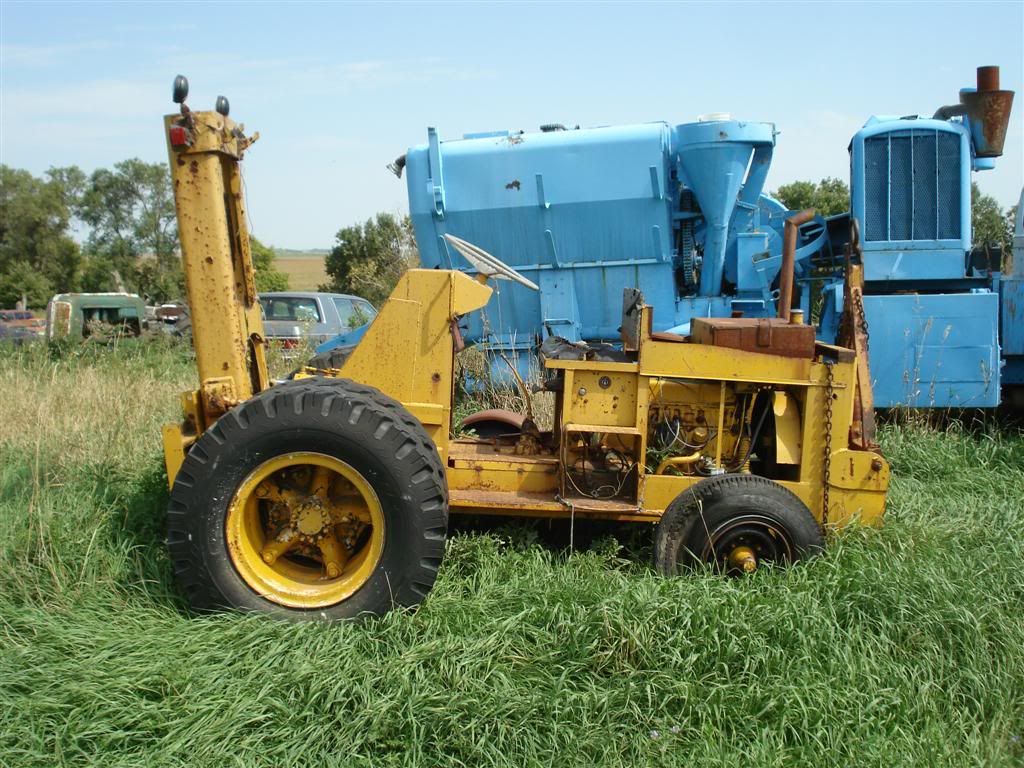

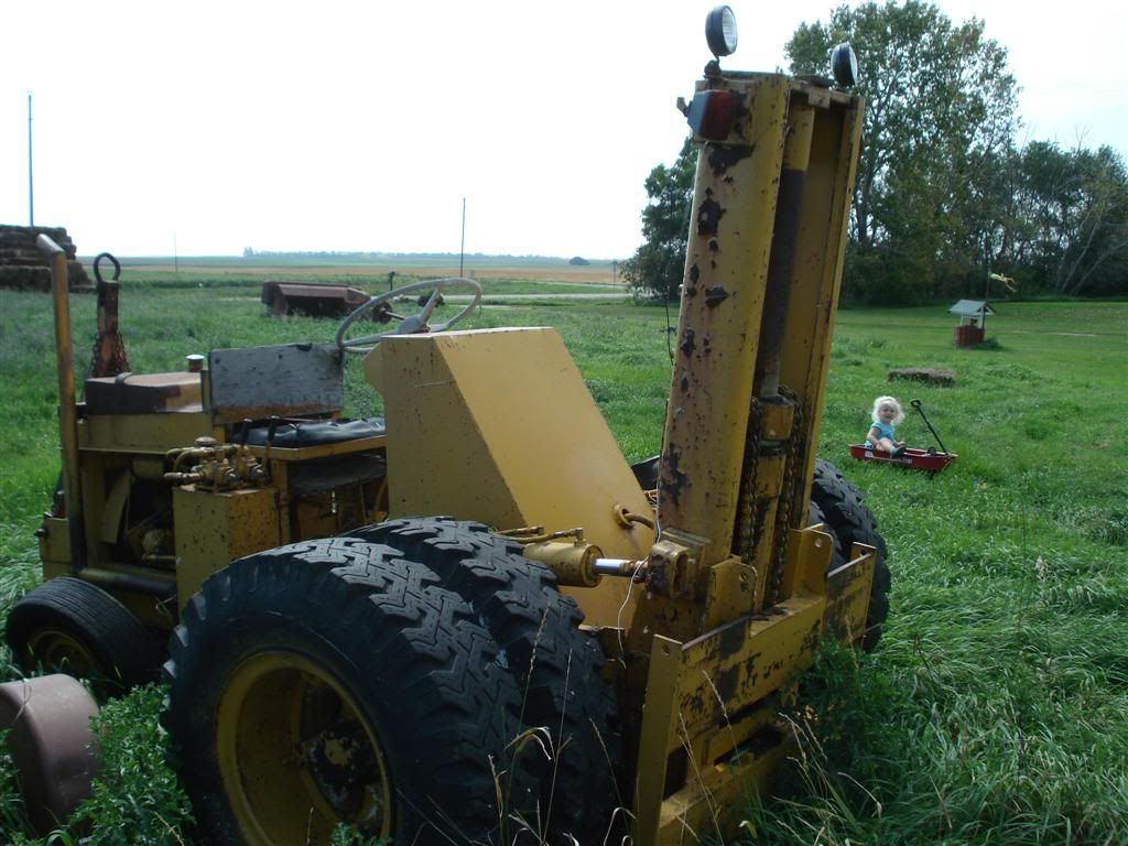

Actually that first picture is giving me some bad ideas.. My Dad is a retired truck driver and along the journey, he has acquired 3 forklifts and he has this one large one that he never uses because the brakes are locked up on it..
In these Pictures the counterweight is taken off to make it easier to 'drag' around, I was planning on torching the drum brakes off of this and then adapting on some disc brakes for him to use, but now I have other ideas..
I have been wanting to lift my pontoon off my trailer for maintenance and to rebalance it and was thinking about building some A-frame structures. But if I can get this from Dad, I can use it for moving my pontoon around and loading haybales (round ones for the horses)

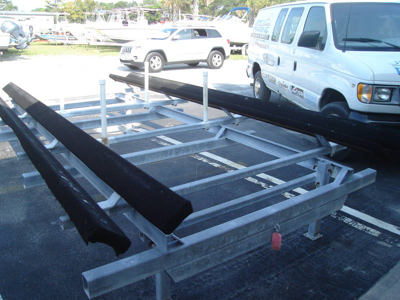

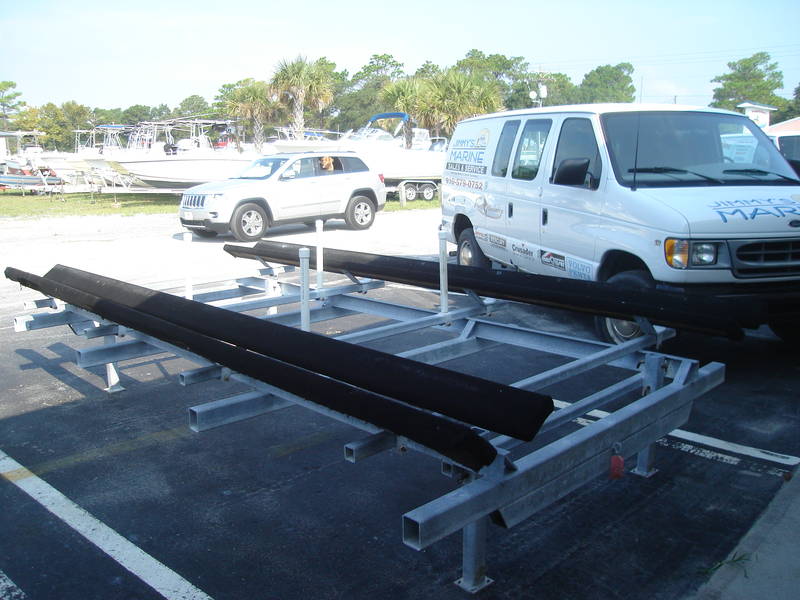

One gentleman posted pictures when a marina dented up his toons pretty bad with a forklift. That's what the first picture's about. The marina had to pay for repairs. I can see where they're particular.
RonB's pictures are of a triple first class commercially built rack. That rack looks like it'd weigh 1500 lbs. without the boat. It would probably have $2,000 in galvanized square tubing and probably cost well over $3,000 new.
You would probably have to go to a welding shop to have them fabricate one. Last week, I fabricated a flat 11' x 18' rack (5 crosspieces) to hang in my boathouse out of 4" channel iron for $500 in materials. If you used the commercial V bolster hangers (like in RonB's picture), it would be stable enough to do the job. The marina should have some input to what they'd require.
Warehouse marina storage is expensive enough without having to have a rack fabricated. Do you have less expensive alternatives, such as covered mini-storage just off lake? That would require trailering the boat just a short distance. Or, do they have boathouses that will allow a lift of some kind?
