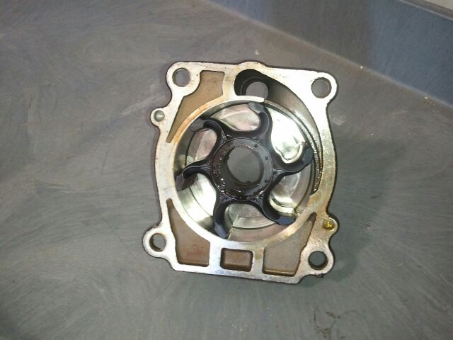

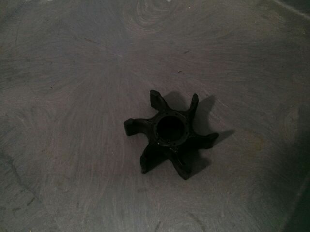

So I've been tinkering around with my DT200 Suzuki, trying to get it dialed in. I bought it in the winter, for a good price. Could't hear it run, but it had good compression and good spark so I took a chance. Well...after a few minor issues I got it fired up. Took it to the lake for a test ride and it wouldn't idle in the water. So I figured carbs need cleaned, home I go. Cleaned the carbs, thought I'd try running it in a barrel to simulate the real world. Well that didn't work, with the big motor as soon as I put it in gear if blows all the water out of my small barrell :hammer . So I clean every thing up, and the next time I get around to tinkering with it I hook up the muffs...and no water. Nothing from the Pee hole. OK...maybe I smoked the impeller whith the barrel mess. Finialy today I pulled the pump, and it looks good? What do you guys think? Is it possible some thing got dislodged and is just blocking the Pee hole? :donno

Posts: 400
Re: Cooling System Question
#2 Post by jrolin1 » Wed Aug 01, 2012 12:56 pm
Something could certainly be blocking the pee hole. Try unclogging it with some heavy mono or something similar. I would go ahead and replace the impeller since you have it off though and can't be sure about how old it is.

#12 Post by GregF » Wed Aug 01, 2012 4:55 pm
That is a bad impeller, on a par with the one I know ran 1848 hours.
It may pump water at cruise speed when centrifugal force will straighten out those vanes but at slow speed your water pressure is barely "pee worthy".

#13 Post by LocoCoco » Thu Aug 02, 2012 5:53 am
Yes, that impeller should be replaced. When removed, the blades should go back to their normal position. However, I don't think it's too bad to not pump water at all. Regardless, now that it's out it'd be stupid to not replace it.
#15 Post by NH Tooner » Thu Aug 02, 2012 11:18 am
Some motors wont pee till the stats open. May need a little time to warm up. Pop the line off the block and blow air out from that end instead of from the p hole in. That impeller should pump water. It doesnt look that bad but change it anyway. If you have an intake screen, check that too. If you have a plastic nipple for a p hole like mercs do, take that off and clean from the inside. That hole is a lot smaller diameter than the hose. A small grain of sand will clog it.
