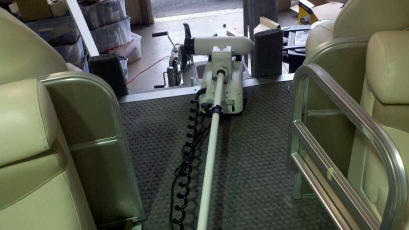

Yes I mounted a MinnKota Rip Tide. salt version of the terrova. I mounted between two tubes. Doesnt matter which side. Slight angle so I could fit when stowed. Cut the front gate. Works very well. Also make sure it will not hit the trailer.
- Big boat 55 298.jpg (46.08 KiB) Viewed 3319 times

here is how mine is mounted, I have roughly 32" of deck in front of the railing. I have it set up so it drops down direct between 2 pontoons so I can use it in really shallow water if I need to so the "thrust" is directed down the channel between 2 tubes. I also have a angled front though and set it up that way when I re-decked it this spring JUST so I could mount the troller this way. I didn't want it to interfere with foot traffic as I have young children that go with use quite frequently.
