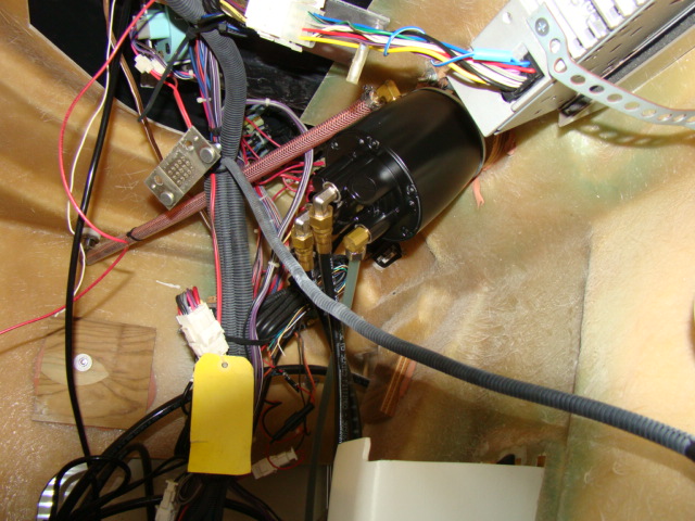

I'm thinking of adding Power assist steering, as my 2 young Grand Daughters want to steer the boat and it's stiff for them. I will have the dealer install it but am wondering where in the boat the unit has to be installed?
Can it be under the helm? or on the back deck or battery compartment? Appreciate your info.
Carl, I remember you installed your own, where did you install it?

Here ya go Ken.
- under helm.JPG (137.87 KiB) Viewed 4752 times
- steering pump.JPG (133.94 KiB) Viewed 4750 times

Thanks Carl, That's what I was hopeing to see.
