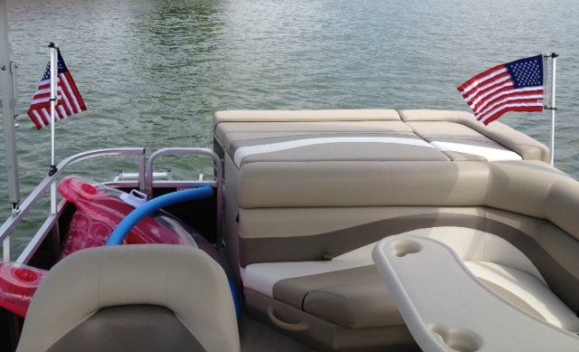

I used a 3ft piece of 3/4 PVC and used heavy zip ties to mount on backward slanting Bimini frame. I drilled a hole through pole and PVC and used a 1/4 stainless bolt to secure. Been there 3 years with no problems.
You can see it here
