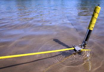

There have been a few on here (not me) that have said they used one of these
Shore Spike
with satisfactory results.

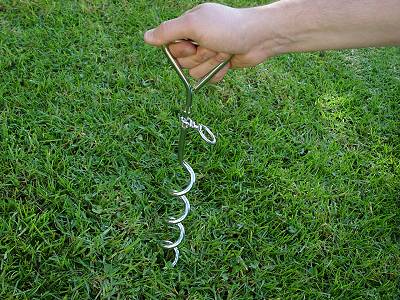

I use one of those spiral dog tie-outs and a bungee cord -- work for us.

On our sand bar everyone uses one made of pvc pipe with a screw auger at the bottom. The local Ace sells them for $20. Would be easy to make out of 1-1/4" PVC. Just need a straight section and a small piece to male a T-handle top so you can easily twist it. Another style I have seen is just a pointed steel post that they stick straight down in the sand.

Not sure who posted it but I used the idea. Get an 8' length of grounding rod at Menards for 8 bucks. I welded an 8" piece of 1/2" rod on top for a T handle . Welded a ring on top of that for a rope clasp and good to go. Cheap version of the fiberglass pole that was posted in another link. I also can pull up to the sand bar and just stick it through my bow eye for a short stop . I have one with the copper sheathing and made a second one out of galvanized.
Added the link. Same theory as this.http://www.stickitanchorpins.com/
