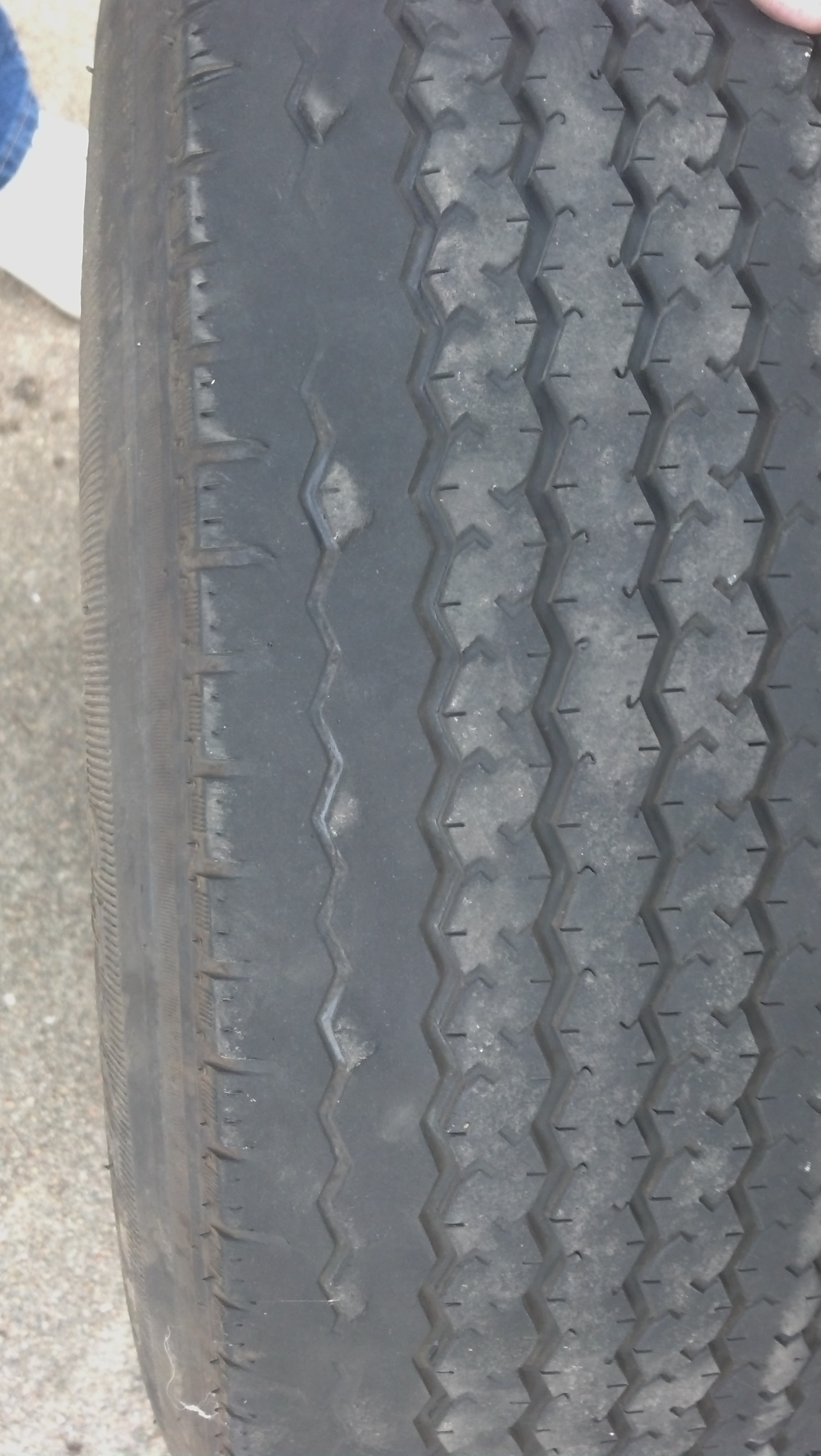

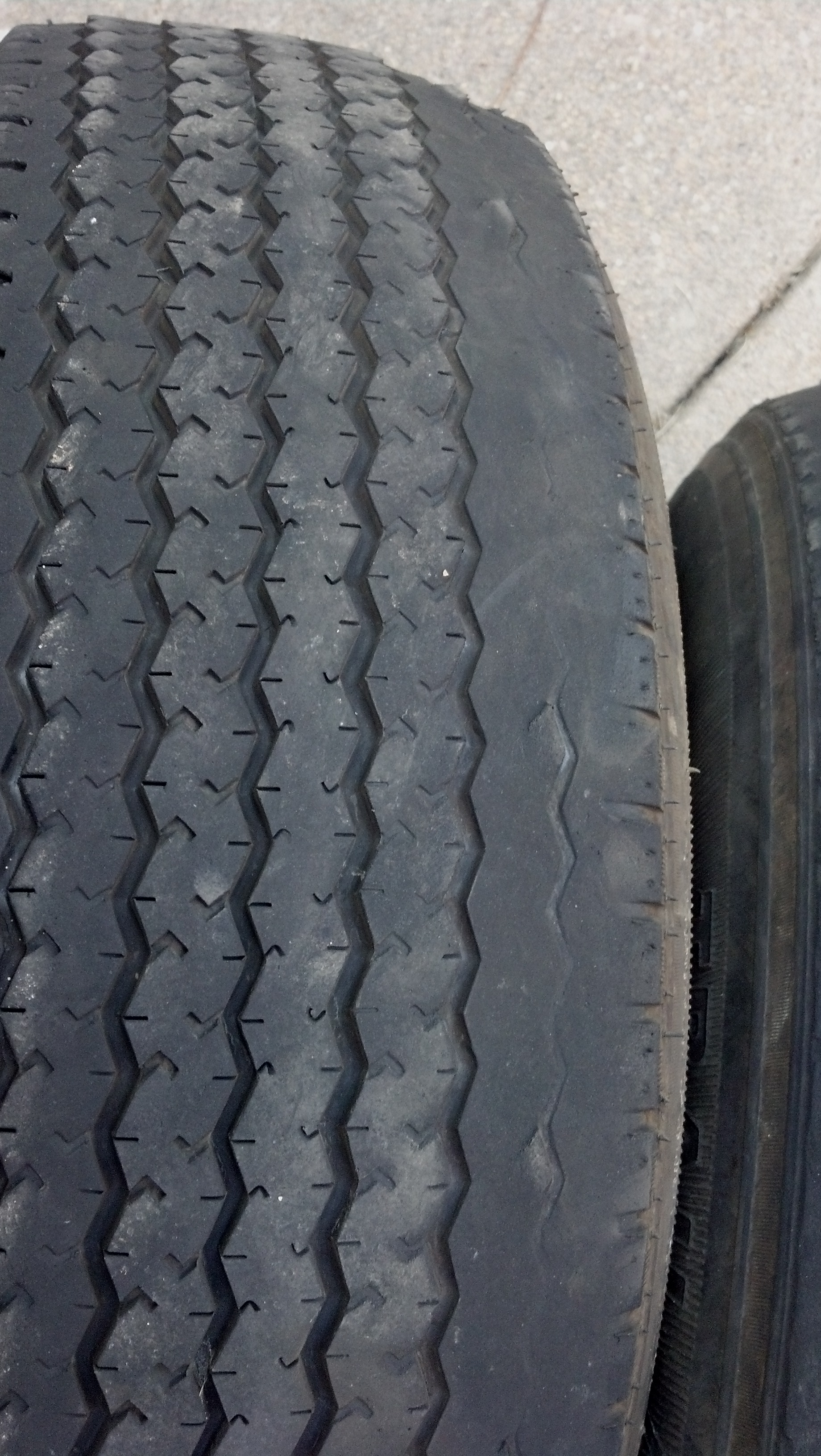

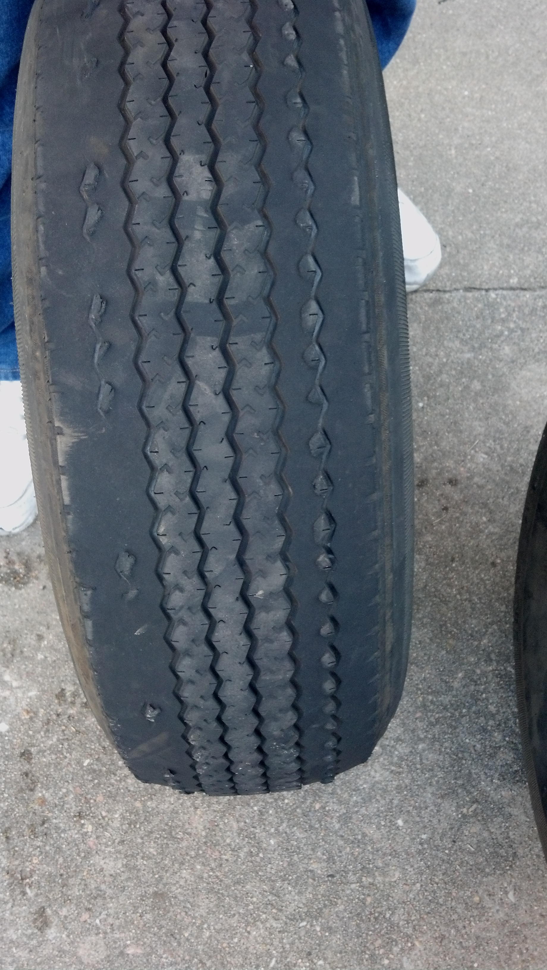

We've got about 800-900 miles on our new Suntracker 21' boat trailer. The tires are junk. We just had to purchase new tires as we are 75 miles from the dealer in Ponca City, OK. No way we would have driven on these tires on the turnpike. The dealer is ignoring us. I love how much they "love" you until after the purchase! These tires were made in China. They were manufactured in 2009 and were on our 2011 boat trailer. I'm not sure if the age is an issue. The boat has always been stored in a covered storage area.

Looks like cupping or feathering damage. If the tires were properly inflated, then it looks like an axle alignment issue. I'd harass the hell out of the dealer until they fix it.
Re: Trail America bad tires
My husband had checked the tire pressure and it was fine. We'll have the alignment checked on the trailer.

I'm going to guess that ou have a single axle trailer under your pontoon boat. Those tires were either over loaded or under inflated to wear like that. First look to see what the axle tag says the axle is rated for then if the axles can handle the weight jump up a rim size/higher load rating if you have the room. I've seen alot of 20-22' pontoons SOLD with a single axle trailer that's over loaded from the get go, then you add gas, coolers, and other toys and they become a ticking time bomb. Worse yet is some of these trailers are coming with only 2000# rated axles!
I was thinking the same thing, that first picture where the center tread is still 'good' looking but the edges are worn down is usually an indicator that the tire was underflated, the tire shoulders will end up taking up all the weight and the center tread will fold/buckle back into the center.
The second picture looks like the axle is out of alignment causing the tire to sit funny and wear out.

Never had a problem with my tracker trailer. Original tires have been on since 2005, replaced them about a month ago because of age, they still looked good. Had approximately 15/16,000 miles on them. Looks to me like an alignment problem, probably toe in/ toe out you will need to take it to a frame alignment shop if the axle needs to be bent. If you can wait to replace the tires try e-trailer.com and look at the kenda tires they are a very good tire and fairly priced. I upgraded to a load range D tire for extra safety it is actually an 8 ply tire and they have both radial and bias ply tires. Good Luck WAYNE

Agreed. Don't expect any warranty coverage for underinflated tires. But, if you can show the tires/axles were overloaded, you should have a good case. Good luck!ronb wrote:I was thinking the same thing, that first picture where the center tread is still 'good' looking but the edges are worn down is usually an indicator that the tire was underflated, the tire shoulders will end up taking up all the weight and the center tread will fold/buckle back into the center.
-ron

Based on the photos, I agree with under-inflated or overloaded.
I am using 50 PSI for a 20' 90 HP single axle. Wear pattern is OK so far and tire isn't hot after a 55 MPH run in 90+ weather.
Max pressure on sidewall is 60 PSI.
