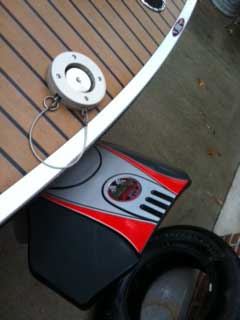

Stingray has come out with a new model that installs without drilling any holes and it has a curved shaped to better match the shape of the prop wash. I am hoping to install one in the next week or so and test it, I'll post photos and results.

I just installed the Stingray XR III on my toon. It took about 2 minutes and a 1/2" socket. No drilling required. I don't know how it works yet, but I think my boat will go at least 10 mph faster just by how "racy" it looks!!! I'll post results after this weekend.

Yeah, I read similar reports and apparently they used to "snap" on to the cavitation plate and that was a problem. Now you must remove the torque tab, slide the stingray onto the cav plate and the replace the torque tab thru a hole in th stingray back into the cav plate in essence bolting it to your drive. But, that doesn't mean the torque tab couldn't loosen and fall out and then you lose the tab and the stingray. I guess time will tell. More importantly is does it actually have any positive effects on pontoon performance.

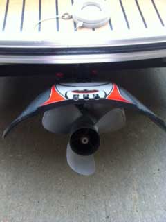

dlettow, In the bottom picture it looks like your prop has a folded blade, is it? Or is it just the picture? Let us know how the Stingray works. Looks like its gonna create alot of drag and slow you down some. Let ua know!

No, there isn't any blades that fold. Must just be a seam or something. I'll post results.
