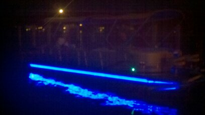

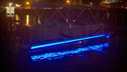

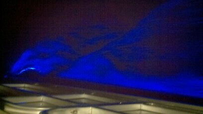

These are off of my cell phone but you get the idea.
And yes as boatcop says check the regs in your state.

Thanks guys!
Steve that is exactly what I was thinking! I am planning on running both strips that way. Do you have them on both sides, and if so, are they connected, or do they each have a separate power plug? Thanks again!

They are on both sides-the adhesive that is on the lights is not good so plan on using your glue of choice to secure them-I have both sides wired into the battery at the rear of the boat-I only use them anchored and they do attract shad and I was told they wouldn't attract bugs but the bugs around here didn't read that they shouldn't be attracted to LED's.
I also put amber lights inside- it really helped light up the inside.
Both inside and outside are on a separate toggle switch.

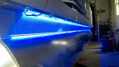

Im' in NH I can use any color I want but only while anchored or docked. No lights other than nav lights while underway.

I have the 3m tape only. holding well. I did clean the aluminium good with laquer thinner
