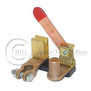

may have lost exactly where we are with this thread, but northern use to sell a device that hooked to the battery terminal directly an you could kill the power right there. Sort of an anti theft switch.
doc
doc
Re: What are my options?
My old International 856D tractor had one of those. Even after replacing the alternator/regulator and fixing all the wiring gremlins I still had a battery drain (slow but it was still there) until I installed the battery switch. It looked just like this..

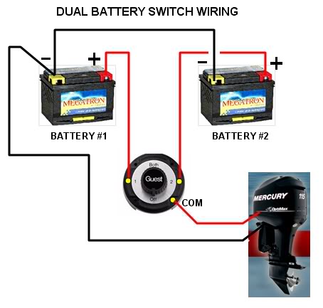

No way that ECU isn't "burned in" as they say. Just do it yourself. you'll have the satisfaction of knowing you did it yourself and you'll know it's done right. It's real simple, here's the diagram:
- StandardBatterySwitchWiring.jpg (27.35 KiB) Viewed 3276 times

Thats how my Verado is wired, haven't had a problem yet!slingshot wrote:No way that ECU isn't "burned in" as they say. Just do it yourself. you'll have the satisfaction of knowing you did it yourself and you'll know it's done right. It's real simple, here's the diagram:
