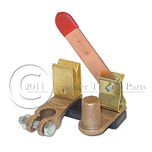

by dockholiday
may have lost exactly where we are with this thread, but northern use to sell a device that hooked to the battery terminal directly an you could kill the power right there. Sort of an anti theft switch.
doc
Re: What are my options?
Posted: Tue Oct 09, 2012 1:37 pm
by ronb
My old International 856D tractor had one of those. Even after replacing the alternator/regulator and fixing all the wiring gremlins I still had a battery drain (slow but it was still there) until I installed the battery switch. It looked just like this..
