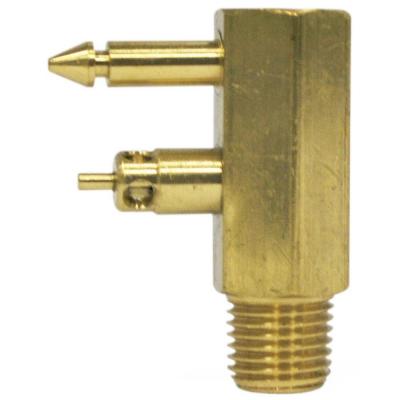

It looks like a pretty easy fix. There is a clip that holds the fuel line on the male quick connect, and some type of bolt holding the connect to the motor. Hopefully I can find one today.

I actually just grabbed that photo from google to show what I needed. The actual part is a little different. I picked it up from the parts shop today. It was $22 for a factory replacement.
