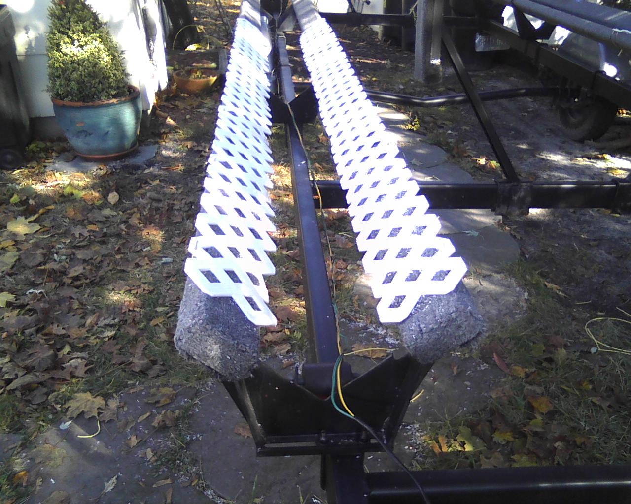

#6 Post by fishinnut » Tue Oct 23, 2012 9:12 am
How's the lattice attached to the bunk?
idadell70
Posts: 28
Joined: Tue May 17, 2011 2:05 am
Re: Trailer bunk slides??
#7 Post by idadell70 » Tue Oct 23, 2012 4:29 pm
The lattice is wired every 2 ft. If you look closely you can see in the pix. Used #12 single strand copper . The glides work fantastic .

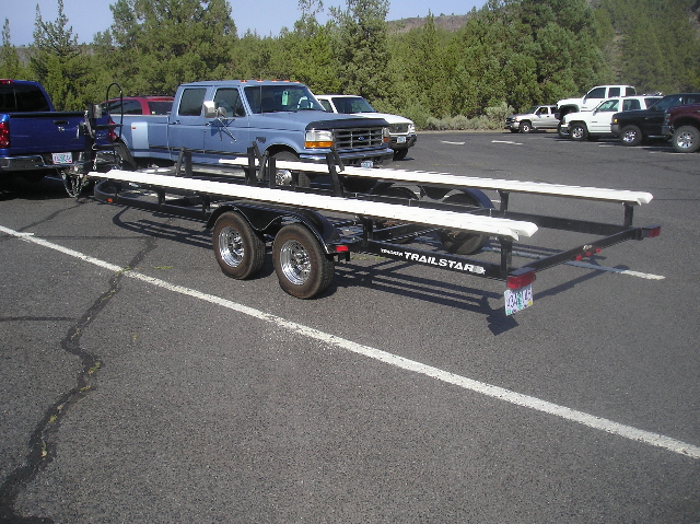

There's been quiet a number of post here on bunks, and while I can appreciate trying to find a low dollar alternatives, these bunk caps from Eastern Marine go over plain un-carpeted wooden bunks, works fantastic and will last the life of any toon. Well worth the money
#9 Post by ROLAND » Wed Oct 24, 2012 1:45 am
yep, I still like what chillin is using... think when the time comes that I have to do something with my trailer bunks, that's the way I'm gonna go.... looks good chillin.. since you've had them awhile, are they holding up good... curious as to how much of a difference do they make loading and unloading vs. carpet.... also do they put any "marks" on your toons...

#10 Post by chill'nthemost » Wed Oct 24, 2012 9:26 pm
No marks and it made a noticeable difference launching and loading. My wife makes it look so easy even in windy conditions it's hard to tell sometimes. I've always been thankful she's never been able to back up a trailer and that gig is her's. In 8 years I've never even tried to load and I really don't want the job. I still grin a little bit when I drive through the parking lots and see all the torn and rotten carpets on most of the trailers, makes me feel better about spending the money

idadell70 wrote:The lattice is wired every 2 ft. If you look closely you can see in the pix. Used #12 single strand copper . The glides work fantastic .
Just make sure that copper isn't in contact with your logs. If so, you are going to have holes in a few years... :scared

#14 Post by idadell70 » Fri Oct 26, 2012 11:44 pm
the lattice is 6 inches wide and overlaps the 2x4. when you wire it you pull the wire snug and the lattice bends away and down slightly.. when loaded the pontoons are over 2 inches from the wire due to the curve of the pontoon and the bend of the lattice . the wire is also plastic coated. I only put the lattice on the front 1/2 of the bunks because the rear is under water when launching and boat floats off that part. when pulled out the boat rests on the rear carpeting and provided grab for safe trailering. the front with the lattice over the carpeting underneath still provides some cushioning from the carpet. cant impress how slick/slippery the plastic lattice is and how well this setup works and also how cheap and easy to install.

#15 Post by fishinnut » Mon Oct 29, 2012 11:30 am
