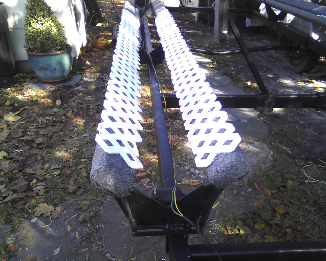

How's the lattice attached to the bunk?

The lattice is wired every 2 ft. If you look closely you can see in the pix. Used #12 single strand copper . The glides work fantastic .

idadell70 wrote:The lattice is wired every 2 ft. If you look closely you can see in the pix. Used #12 single strand copper . The glides work fantastic .
Just make sure that copper isn't in contact with your logs. If so, you are going to have holes in a few years... :scared

the lattice is 6 inches wide and overlaps the 2x4. when you wire it you pull the wire snug and the lattice bends away and down slightly.. when loaded the pontoons are over 2 inches from the wire due to the curve of the pontoon and the bend of the lattice . the wire is also plastic coated. I only put the lattice on the front 1/2 of the bunks because the rear is under water when launching and boat floats off that part. when pulled out the boat rests on the rear carpeting and provided grab for safe trailering. the front with the lattice over the carpeting underneath still provides some cushioning from the carpet. cant impress how slick/slippery the plastic lattice is and how well this setup works and also how cheap and easy to install.
