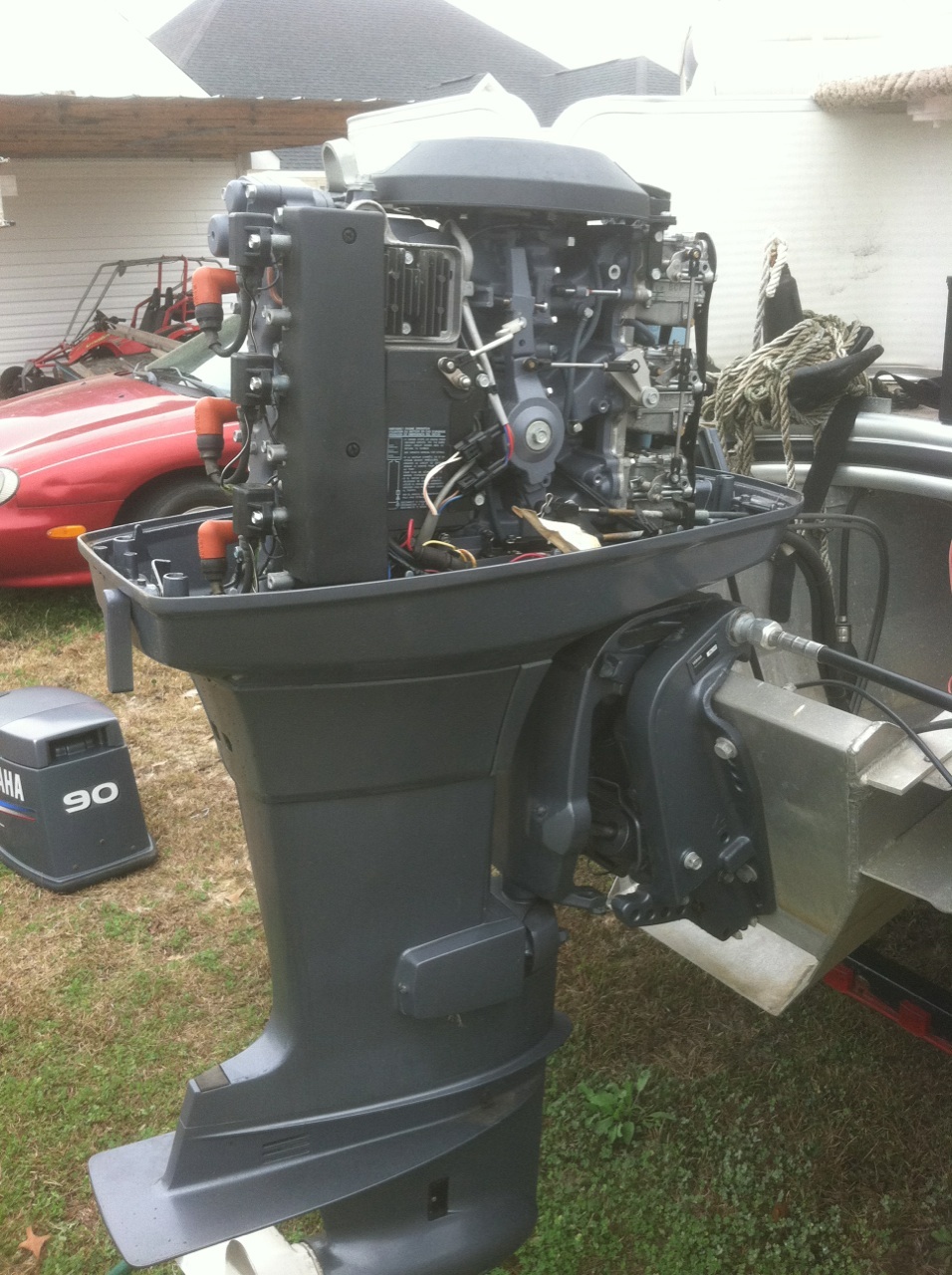

Post pictures from the back showing the motor and transom maybe we can spot what is wrong before you spend any money.

margaritaman wrote:Post pictures from the back showing the motor and transom maybe we can spot what is wrong before you spend any money.
+1 :thumbsup

#15 Post by MH Hawker » Wed Nov 07, 2012 5:34 pm
And because of how your transom is made you have two choices, cut the center section out and replace with marine plywood so you can lower it, or buy a jack plate, and a jack plate would be my recommendation, A jack plate would be a lot easier to dial in.
