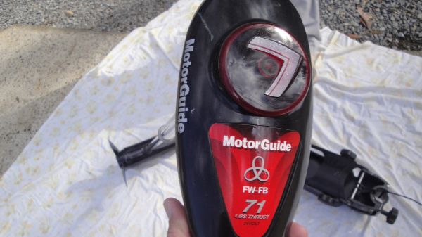

I am completely new to pontoons so please excuse if I decide to ask dumb questions. Recently bought a 2006 Starcraft 20' fishing pontoon. I think I want a trolling motor. I have found a "lightly used" 24 volt 71 pound Motorguide for under 400 that was on a pontoon. It is a standard trolling motor mount like used on bass boats. Seems to be good price and I like the idea of bigger power but I am not sure how it will work in the front gate when loaded on the trailer. Any comments or suggestions?

I do have the half front gate so probably go under the gate. The loss of room and the front gate use concerns me. It is a foot control so there is more hardware added to deck. My fence goes all the way to front of the boat. Will the stored motor stick out past front of deck and run the risk of getting destroyed by boarding ladder on the trailer?

this picture shows mount better, I hope
